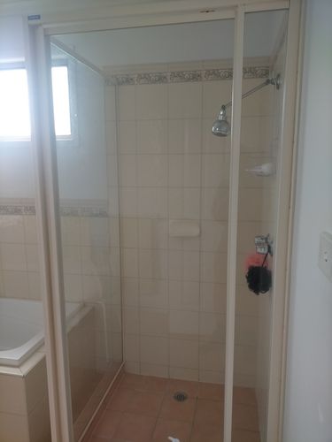

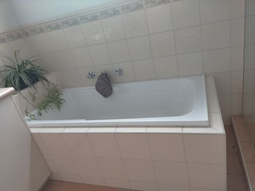

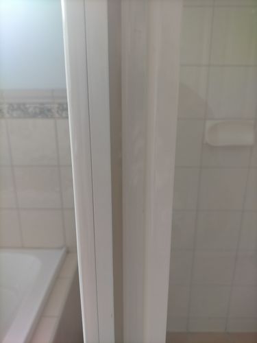

Hi Jason, thanks so much for the response! In the early stages of planning so any and all advice is do helpful. I have included a couple of pictures of the shower and bath tiles that I am wanting to update....
Sounds like the floor will take some more research 😉
Hopinh to use the Rust-Oleum Tile Transformations Tile Coating System on the shower and bath wall areas.

It's great that you've received fantastic advice from @Jason. There are currently three brands of tile paint available in the store. They are the Dulux Renovation RangeWhite Knight Tile And Laminate Paint, and Rust-Oleum Tile Transformations Coating System. These are all excellent tile painting systems. However, as Jason has mentioned none of them are suitable for in-shower use. Please note that if you do use it inside the shower, it will not be covered under the paint's warranty.
Painting your powder-coated shower frame is like painting the frame of your aluminum window. The area must be prepared, a primer must be used before you paint your first base coat on. I recommend exploring the option of tiling over the existing tiles in the shower area. This will bring your shower area in line with the newly painted tiles. This looks like a fantastic project in the making, any updates on your progress while you renovate would be much appreciated.
