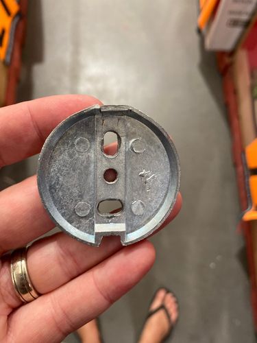

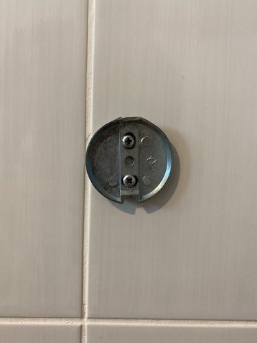

Hi all, the wall Mount for my towel rail has bent and the rail keeps falling off the wall. I am looking for a new mount for the wall but the new ones are smaller. The Mount would be about 20 years old. It is 50mm in diameter with 10mm between the screw holes. See attached image.

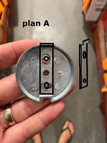

Plan A use flat bit of thin 1mm max and make it fit to replace the old damaged bent lip. Either bend it to z shape or file a lip into flat steel.

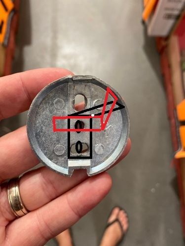

Plan B can a right angle bracket fit into the internals of the towel rail fitting and possibly be glued there? same right angle bracket needs to be mounted on base in either the red or black axis this will give stronger mechanical support if some one leans on rail again,

Plan A make new tab.
Plan B bracket into rail fitting

I think that the best satisfaction and easiest option is to replace the towel rail. It can be seen in your photos that the top tab in the mounting plate has actually cracked off. The only repair option I can see is to make a tab as suggested by @Jewelleryrescue , but it seems like a lot of trouble to go to, in order to get a patch-up result, when there are plenty of towel rails available for under $50.

As @Jewelleryrescue has suggested replacing the towel rail with another, unless it’s is an identical rail, I can grantee you the holes will not match the current positions. New hole would need to be drilled, each manufacturer has there own hole patterns and spacing between centres. looking at the mount there is no way you could re-bending the any part of the mount as it is a casting. If it had been a pressed metal there would be a chance to re-bend the mount

2. as suggested plan A has good merit

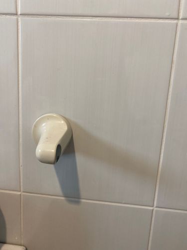

Failing that there is no option but to make new holes in wall but it will be hidden by new fitting cover?
