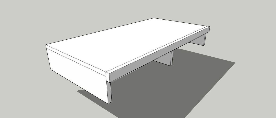

Hey all im just about to put my project together but looking on the different ways of putting it together. what would be the best way to make sure its strong.. first  image is having the sides underneath with an extra small  bit to support. The small bit will be screwed and sides will be glued.

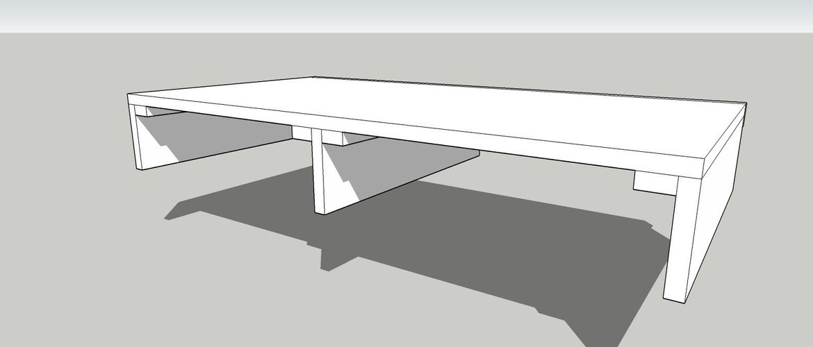

Second image has the side parts directly to the side with the small support underneath.
So question is which will be the best in terms of structual strength? Weight on top will be around 20kg.

To me it is only as strong as the weakest point.
Appearance wise legs underneath will be a better looking option.
Weight from the top is going to make it want to bow and that if it happens it will make the legs splay out putting extra strain on them.
Not sure if you want to use the gap as storage space? I would so I would go with a piece across the back that would both reduce any bowing and strengthen the legs, front and back would be better but you lose any storage space then.

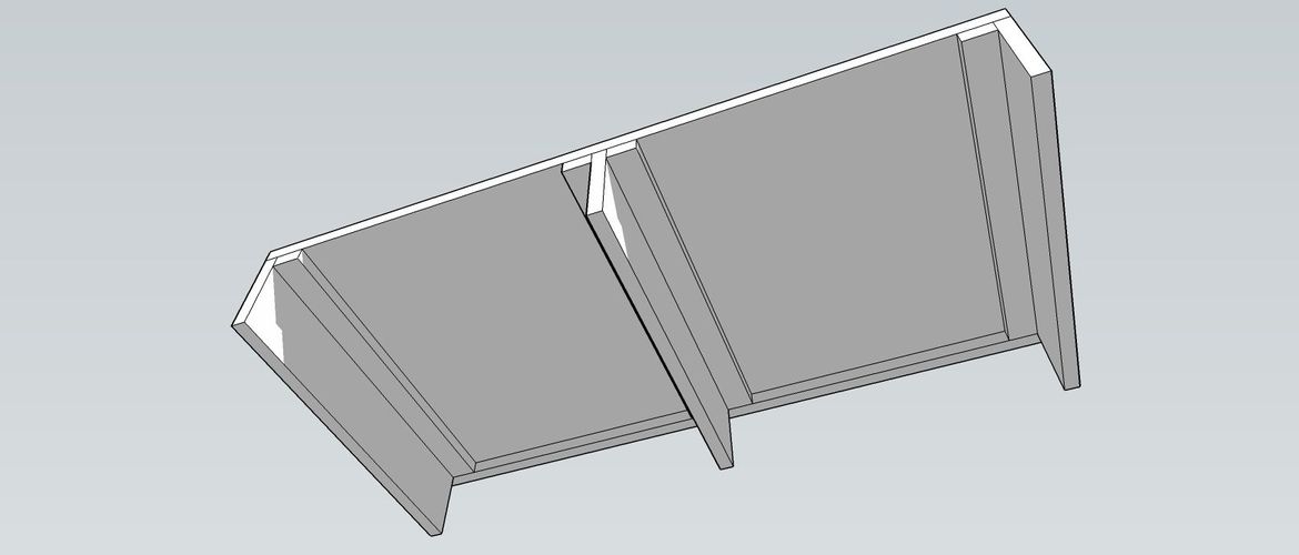

I vote for under the shelf as this has worked for me in the past. Always have a center support to prevent bowing.I vote for under the shelf as this has worked for me in the past. Always have a center support to prevent bowing.A supporting long piece, drilled both into the legs and shelf to prevent swayng and shearing.A supporting long piece, drilled both into the legs and shelf to prevent swayng and shearing.Just in case you want to see what it looks like underneath.Just in case you want to see what it looks like underneath.

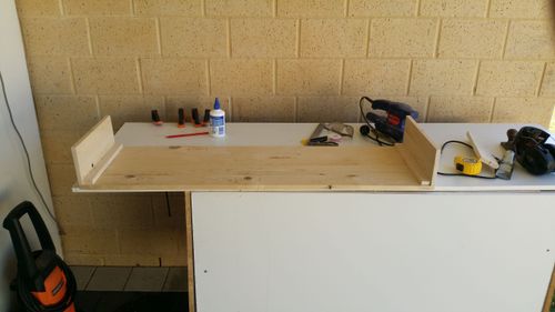

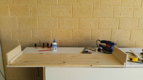

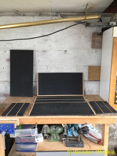

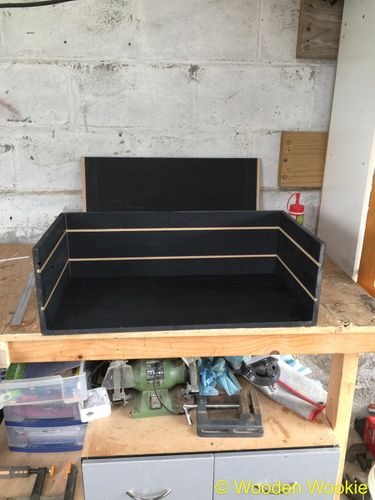

So this is what my project looks like.
Rabbets all cut outRabbets all cut out
Top removedTop removed
Close up of rabbetsClose up of rabbets
All of these photos are showing pre-glueup and fit nicely just through weight alone. As you can see the whole thing wants to square itself up because rabbets are generally a 90º cut.
The shelf is supported on three sides and so is pretty strong even with the length.
I ended up glueing and using 18mm brad nails to hold it all together.

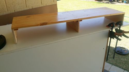

So heres the final product. Much appreciated to the guy with the sketch up above this post. Was a good learning curve considering i lack the woodwork skills but a bit of research got me curious on the different ways i could of done this. I saw the other posts and yep i may just build something similar again. Stay tuned
