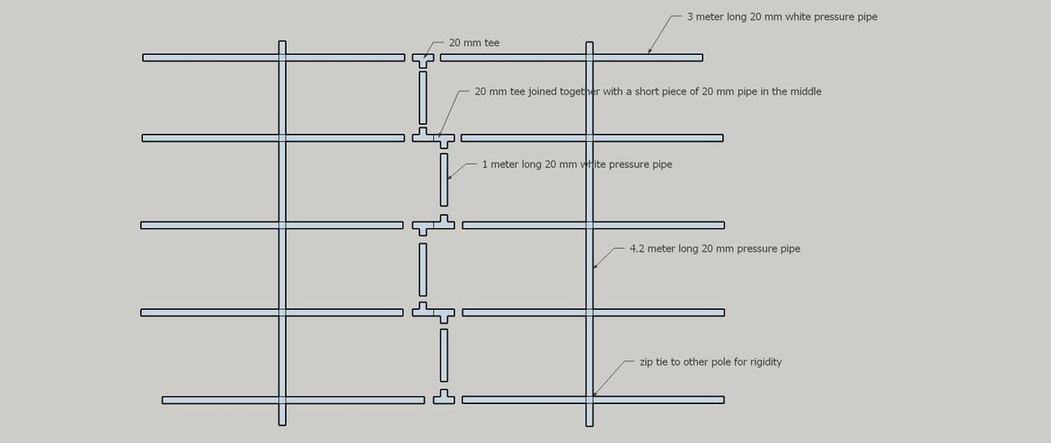

Hello @Bundaboy,
Strong winds? No worry! This contraption has lasted me 10 years and the only thing I had to replace was the tarp! ( I've moved house since then and had to dismantle my temporary garage ) Below is the plan for a half dome car shelter. Now it is very open to interpretation you can add your own twist to it. But seeing as this is Sunny Queensland I do occasionally get strong winds. I strongly suggest to use green pressure glue to make sure you have a strong bond on the 20 mm tee's. Once you have assembled it you literally bend it into a half circle. Make sure the ends are anchored well, if you get hurricane winds I suggest using a large tin with rocks or sand inside it, at least 15 kgs. in weight for each pole. I suggest using the heavy duty silver topped tarpaulin! So that it won't flap in the wind, has very strong UV protection and will last several seasons. You can anchor the entire thing with ropes and deep set steel star pickets. Zip tie everything like there's no tomorrow. Best part is that in high winds this thing flexes, but returns to shape once the wind is gone.
This is a temporary shelter from hail.This is a temporary shelter from hail.This is an example of how it might turn out.This is an example of how it might turn out.

Hah! I was wondering how I could get rid of the stay wire I have in this, my temporary storage solution:
I threw this up with stuff I had on hand to store some garage stuff whilst I cleaned and reorganised my messy and overcrowded "workshop". This has withstood some ferocious winds with only a few of the "clamps" popping off where the tarps are over lapped and therefore a bit of a stretch for these makeshift clamps (split conduit).
I used clamps instead of zip ties to avoid having to puncture the tarps - but I would go with zip ties on a more solid structure as your solution is.
Do you have a source for that heavy duty tarp? I would much prefer to not have the overlap as in my contrivance.
Thanks for that, this approach had crossed my mind but was worried that without the stay wire it wouldn't be stable enough but with your approach it should be. Cheers.
