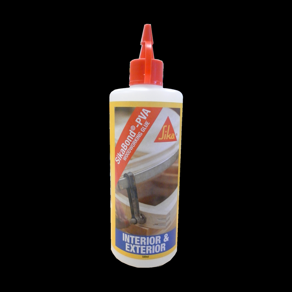

Hi, just wondering what the best brand of wood glue I should get for casual woodworking?
Current choice for me is Sikabond and for Melamine I want to try Titebond Melamine soon.
