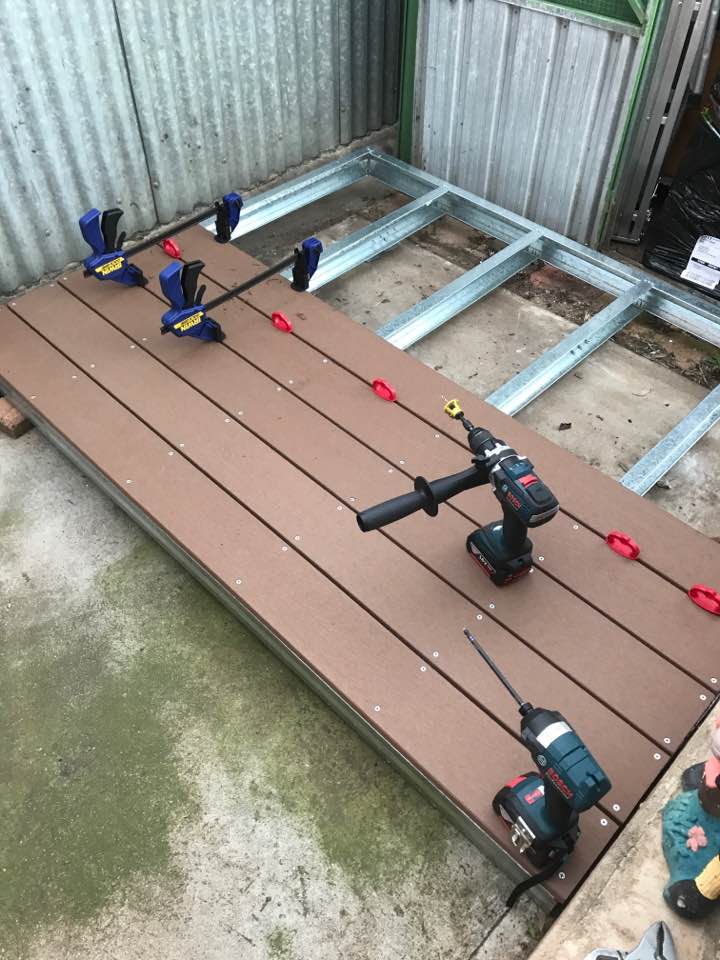

That is the option I went with, steel flooring kit with Ekodeck. I could of rebated the edges if I also put a 45 mitre on the corners for the brackets. Upcoming project is a shade house and I will go treated pine base with Ekodeck top.

Thanks for the reply Brad, couple of questions where did you buy the steel frame kit? is the steel frame just sitting on the floor or is it secured somehow? same with the pine base will you be securing it to the ground somehow or just sitting it there?

Kit came from.
Floor Kit
Kit comes with holddown brackets, I used 6 of them with 4 being dynabolted into concrete and 2 having leveling feet fitted as the gap was larger than the bracket. If going on the ground you could stake it down. Video shows them cutting with snips, it was something I tried and failed so I went with my 18v metal cutting saw. I had enough leftovers to fix the back fence.
If you want to be more DIY.
Purlin
For the pine I am thinking I may have to use leveling feet as there is a slope on the yard from front to back so it might not look right just sitting on the pavers. I may have to use some dynabolts if it looks like it could move.

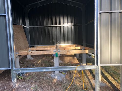

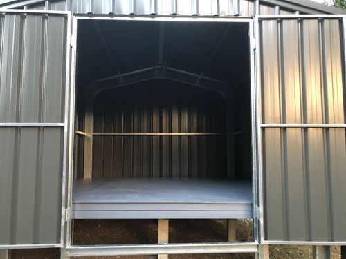

Last year I had a shed built which was on a slope. They wanted to charge a fortune for flooring so did it myself. I got concrete pilings from Bunnings and then built a timber frame. I used plywood for the flooring and painted it to give it durability. Nice and solid.

Thanks Jason - was well worth the effort. I was impressed with the options Bunnings had for shed flooring.
