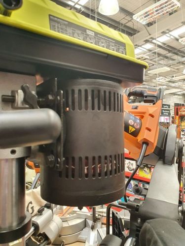

"Drill Press: Ryobi model"
This one?
I'd look for a pedestal drill with more grunt - especially if you consider using large hole saws in the future with your woodwork.
Does anyone know why Ryobi perforated the induction motor casing with hundreds of ventilation(?) slots in the casing?
Up close you can even see the copper coils and wiring inside....just seems cheap and wrong to me.

Noyade
Most likely reason for perforations is to help disapate heat. As current flows through the armature / coils it generates heat. Unfortunately as the wires get hotter they cause resistance which in turn reduces the power of the drill. Same reason why if you are having trouble starting a car you only do quick burst not long continuous cranking as the starter motor gets hot and needs more electricity for same power.  JDE
