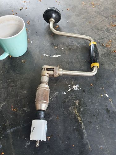

Is the humble Bit & Brace dead and buried?
Can't see it being available on Bunning's website?
Unless your drill has a two-gear function, and assuming the slats are hollow thin aluminium, would it be worthwhile trying this?
With this set up I would try taking two semi-circle slices with the drill bit between the slats. And you can go as slow as you like. 😁
The hole saw illustrated is 38 mm diameter and a Sutton brand.

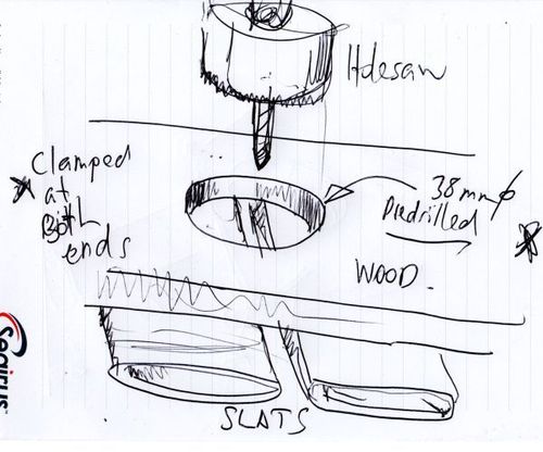

Hmmmm....thinking this over a glass of wine...
Pre-drill or drill through a piece of wood with it clamped so that the hole-saw drill bit is between the slats and this way the hole-saw will not wander....
Or you've already made your hole - and I'm wasting drinking time mulling this over. 😏
