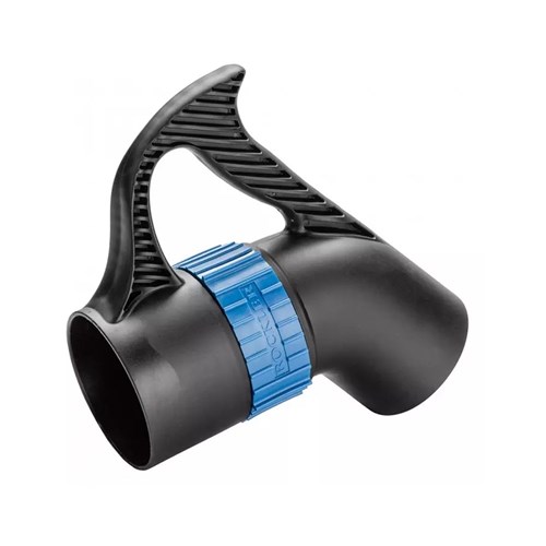

Where can I purchase the quick connect dust hose connector as shown in the last photo.
Thanks Nifty.
Wayne
Super Contributor
Re: Down Draft Sanding Table
It is made by Rockler and part of their Dust Right Quick Connect series, I purchased it from Carbatec but having just had a quick look I can't find a link for it on their website. Here is the link for the US Rockler website though http://www.rockler.com/dust-collection/hose-end-attachments

Hi Wayne,
Thanks for info. Found it here on the Carbatec - https://www.carbatec.com.au/dust-control/dust-extraction-fittings/rockler-4-dust-right-quick-fit-han...
