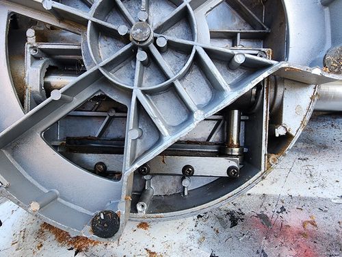

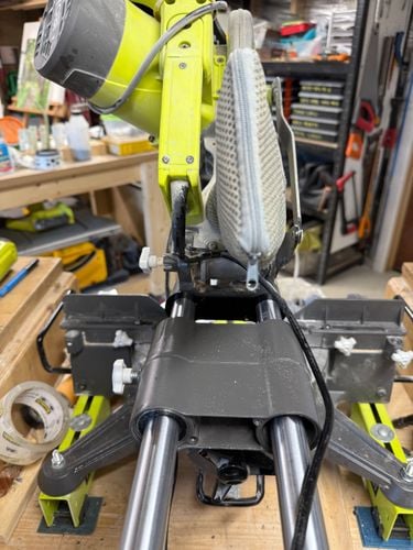

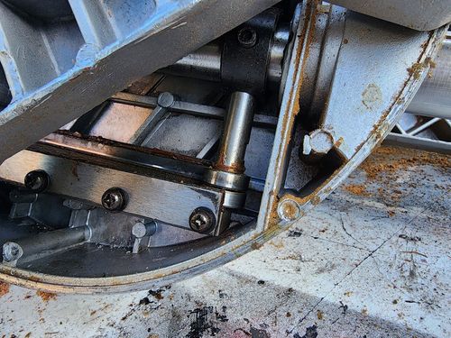

I bought a rather nice (for my many uses) Ryobi two way Combination Miter Saw. I noticed today (Friday 18 April 2025) that the saw guide was somehow stuck; it would not roll back and forth on its two poles guide rails. After a more confident “nudge” it started rolling but sounded and felt a bit rough. so I remove the two cover plate (see photos) and cleaned up all I could (saw debris) and applied WD40 to get the guide moving.

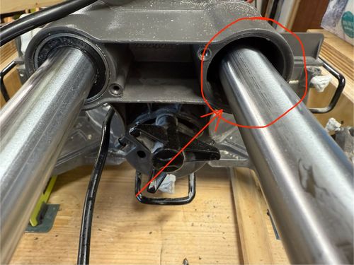

Upon cleaning I noticed (see photos) that the housing that contains the roller bearings seems to have a bearing missing!
So my question is, should My Ryobi Miter have a Baeribg in that empty position?
