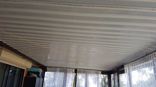

The sunroom is 7m(L)X3m(W) and is made from colourbond metal,with glass windows.
The problem is that the roof is not insulated,neither the side frames. The roof is a single metal sheet without any support.
The floor is same as wooden deck and there are gaps. Also its  a raised room so makes it very cold/hot.
Please provide your feedback if its worth implementing following ideas so I can use this room as study & media room.

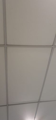

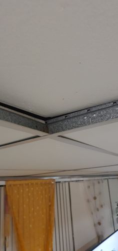

  • Roof insulation : Insulate the colorbond roof(please suggest material and if I can  glue it to roof).Build a light weight metal frame, please suggest the material. The frame can be build by joining to the existing frame using rivet/glue(please suggest). Added a photos (existing roof, idea of frame). Also need to cover using lightweight material (please suggest). I am planning to install downlights in it.

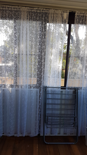

  • Windows : Install roller blinds (please suggest for better insulation).

What you have suggested will reduce the severity of the extreme temperatures that you are experiencing in that room. The only concern I have is those lightweight frames and insulation will add a considerable amount of weight to the unsupported roof. It might be worth installing a structural beam across the centre of the roof to bear some of their weight.
Our supplier Knauf does a complete range of pressed steel suspension ceiling products which you can find instore and through our special orders. However, to install through to the roof sheet would require putting hundreds of holes directly through an exterior roof and I certainly wouldn't recommend this.
In your scenario, I believe constructing stud walls and ceiling would be the best decision. You would create stud frames on the interior walls and ceiling, install insulation and the Gyprock over the top.

Window shutters would be a good idea and you could also consider awnings to prevent the sun from hitting directly on the window panes.

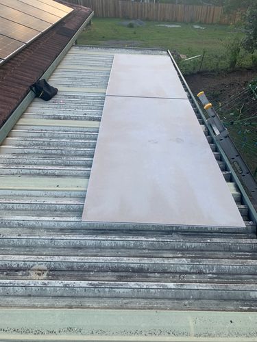

Hello I am interested in this topic as well as have a very similar sun room that is very hot in summer and very cold in winter.
Im wondering if there is any lightweight insulation that is weather proof that could be added to the OUTSIDE ie on top of the roof rather than the inner part of the roof. The I can see if that is enough and then do more for the walls below the windows later if need to. It seems to me most of the heat comes in via the roof.
This way also the insulation will not be taking up some of the floor to ceiling space and may be easier to add?
Your help will be greatly appreciated.
Regards
Terry
ps I just improvised today not sure if it will work. I bought some FC cladding hardie board 6mm thick and under that I placed 25mms of foilboard insulation panel. However I did not put then inside the sunroom but i put them on top of the roof on the outside. So I placed the foilboard under the FC cladding hardie board and then screwed them into the hills of the corrugated colourbond roofing with metal hex screws- i just used 12 gauge 45 mm long. So we will see how that goes with the heat and also if it lasts being on the outside??? Bit of an experiment so far.

Re: Sunroom insulation
Hi @Terryahh,
It sounds like your idea will quite possibly reduce the temperature inside the room. You might need to add the board and sheeting to the entire roof to see a significant result. Make sure you're using screws that have a rubber seal washer on them to prevent water from migrating down the holes into the room.
I'm looking forward to hearing your results.
Thank you Mitchell
 I will do what you suggest and add to the entire roof and see.
The section to the side of the one I just put in won’t take a full Hardie board without cutting it. However I’m thinking of instead of cutting the foam and Hardie board then just raising that one edge with strips of timber and then overlap on top of the already laid insulated hardie board. This way I have a section with air under it and also then a strip section with overlaid double insulation and double Hardie board.
Not sure if any issues with doing that ? Such as possibly making an area that rats or mice might like to make a home in or birds that may then chew the foam?
