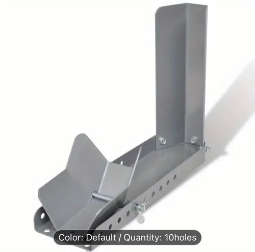

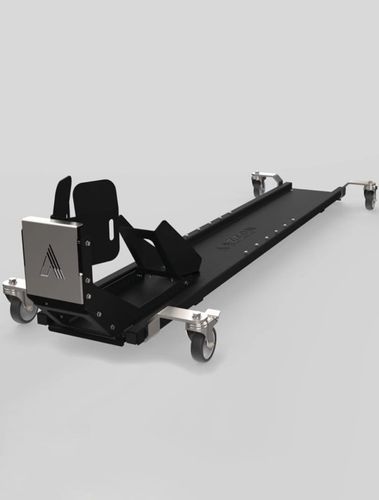

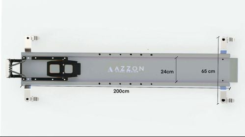

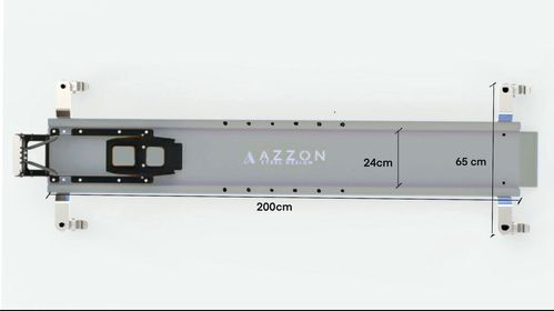

I am trying to build this motorcycle dolly to be able to manoeuvre it around the garage easily. I have attached some photos. This may be out of my skill set but looking to try out and thought you guys could help me get started.
