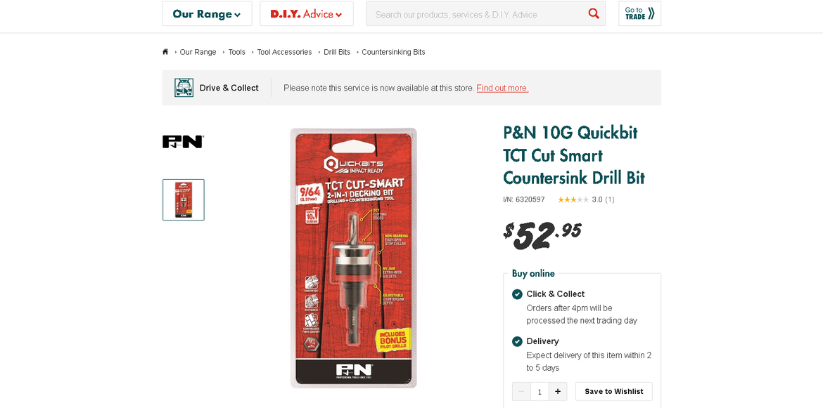

This is what I use when I do counter sink holes. My favorite in my bit box.
