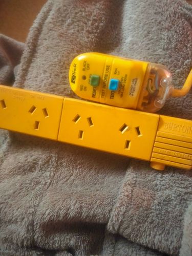

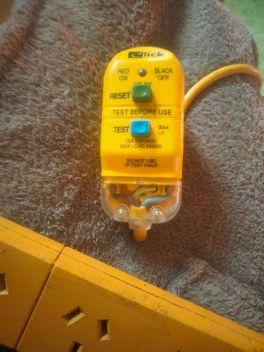

Thankyou Alan. I actually have a power board with I believe a safety switch on it, will that do the trick ?  Board is rated at 2400w.
It's a click product.

Re: How to determine whether extension cord is 15a?
Sorry. Here is a clearer photo
