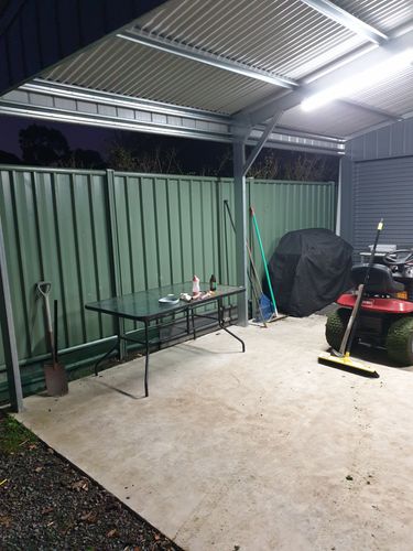

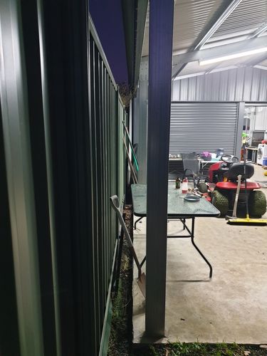

Just wondering on suggestions on how to best encolse the side of our carport.

What were the reasons for wanting to enclose the carport? Was it just to prevent rain from coming in, or were you looking for a solid wall? To prevent rain, fixing some polycarbonate roof sheets from just under the gutter to the top of the fence would be a solution. It would likely be best to check with your neighbour to see if they were happy with this arrangement, as the water captured by the sheets will probably end up on their side. Alternatively, you could make those sheets finish just below the top of the fence so the water falls on your side. Attaching the sheets in the sloped position can easily be done if you install a couple of timber batons along the fence line and roof.
Alternatively, you can run timber horizontally between the carport's posts. This will allow you to fix the sheeting off in a vertical position, creating a wall from the sheeting. I've recently done this to my carport, and it worked exceptionally well to keep the weather out and add privacy.

When you say "enclosed" is it the side against the fence or potentially all around the carport? At the moment I love slats lol I seem to be putting them up everywhere at home. You could put a post between your metal supports and run some slats horizontaly. Not sure if you want to soften the side f the fnce or protect from rain? If you wnat to make a fance outdside area then how about the large shadow rectangles made of recyled plastic with shapes cut in them? Like this Screen panel
The second thought is if you put a screen up you will loose around 200mm and potentially make it harder to open your car doors?
And my brain is off on a tangent... I never use my garage or carpot as a garage or carport lol Tho now I want a workshop! Looking forward to claification from you.
Guess it all depends how solid of a structure you want?
If you just want to block out the gap from rain coming in you could just attached some roof panels like suggested to stop it coming in, might need some sort of drainage for the water that may then pool down the side of the fence and slab?
You could also build some frames and attach on the outside of those posts and attach something like weater-tex (https://www.bunnings.com.au/search/products?q=weathertex&sort=BoostOrder&page=1) boards on the outside.
What does the other side look like?? is it also open or is it inclosed?

We are wanting to put a solid wall in to prevent rain (and the neighbours roses falling into the carport) but to also enclose to create an entertainment area!
We were thinking of doing the timber between posts and then attaching the sheets. Any chance you could share a picture of what you have done?

Thanks @Dave-1 for the reply. We are just wanting to enclose 1 side, to be able to create an outdoor entertainment area, with protection from the elements We! We also do not use our carport for our cars 🤦♀️
Id suggest the slats then. Id put in two more posts top to bottom between each of the metal posts. Fasten them with a stirrup to the ground and straight to the metal support at the roof. Attach some tiber posts to the metal posts. That way it will give you something to screw the timber slats to. You will need to give a small gap between the slats as they do bend with the weather. But privacy wise it will work and will stop most of the rain and wind.
