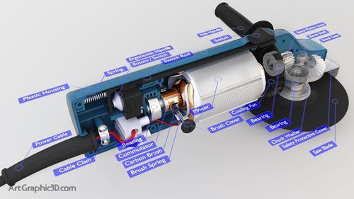

Re: How to fix Ozito PXBVAGS Grinder rocking?
G'day @Noyade,
I will be interested to see what comes back...
Due to the bevel gear setup I would expect a tiny amount of play - by design.
Could be the cheaper ones with no play may have a shorter service life - because they are cheap?
Cheers
