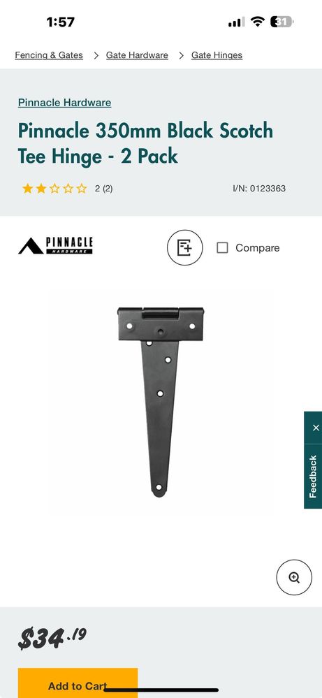

Ok thank you Jacob. This is one option. Our preference is to go with the Tee Hinge see attached. I bought 3 for each side. they are 350mm long. On bunnings Website they dont provide the weight capacity. Can you assist and confirm the following:
Our doors are STPC Duracote 2040 x 1200 x 35mm External solid doors
1. weight capacity
2. Do i use screws or do i use bolts and nuts to go through the wood?
I have spoken to Hume Doors, the producer of the door you have purchased, who have advised that your doors can be hung with three standard butt hinges and if you were still concerned about the weight, a fourth in the orientation I have described earlier would be the way to go. Using heavy-duty ball bearing hinges is not a requirement but it is certainly worthwhile as they're designed to support heavier doors.Tee hinges are not designed for use with doors, and I would strongly recommend you don't use them. If you are still not comfortable, I would strongly suggest contacting a door installer for their assistance. That way if their chosen method of installation fails, they will be responsible for the repair.

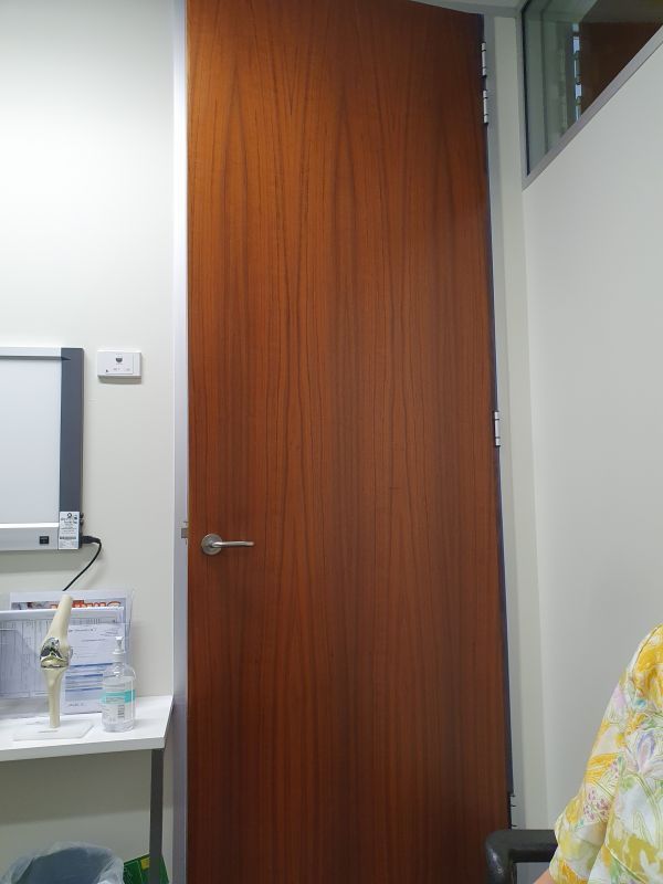

On the subject of doors - saw this one yesterday in an orthopaedic surgeon's office. Massive. Floor to ceiling and solid wood - around 3 metres in height.
And yes - 4 hinges.

As you are aware i am making 2 barn doors for external use and they are very heavy around 55kilos each. So you have recommended i use the heavy 100mm wide hinge heavy duty hinge. They only come in silver. I have purchased these,. However when i was in Bunnings yesterday i saw these T Hinges black (see below picture of it), they say they are heavy duty. Would these hinges be suitable to handle the heave door i have have. Door size 1200mm x 2040 x 35mm x 2 doors.
You could certainly try them. As per the previous recommendations, you'll need to use at least three or more per door. What those hinges don't have is ball bearings, which are commonly used for doors of your size. Ball bearings allow the door to be easily opened and extend the life of the hinge.

So i am 100% sure, would Bunnings be able to verify the specs for these T hinges (they do say heavy duty) that they will be able to handle 60kgs doors that are 1200 wide and how many T hinges would be needed?
I would appreciate this and it will give me piece of mind
The doors you are using are very heavy and exceptionally wide. The information we have based on what the manufacturers have specified is that you should use hinges with ball bearings. The hinges you've selected are gate hinges, not door hinges. So, it's difficult to verify whether they would work on your doors. A heavy-duty gate hinge would be designed for a 900mm wide gate or possibly 1200mm. However, a gate is typically no more than 20kg in weight versus the 45-50kg of your doors.
Due to the weight of your doors and the fact that these hinges do not have ball bearings, it is presumed that the hinge's metal-on-metal design will begin to grind under the weight, diminishing its lifespan. How quickly they will fail is unknown, but it's most likely that they will at some point.
