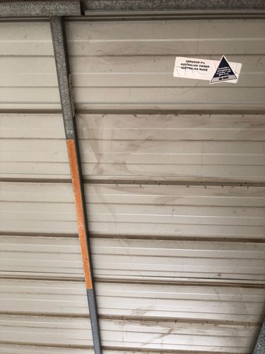

Is the door zink coated? I am more familiar with galv that needs an etch primer when it is new to help the paint stick.

@Brad Thanks for the reply. I don't know if the door is Zinc coated, I only know there is BHP steel logo on it and it's pretty old. See attached photo.

Can you confirm for us whether this is a new uncoated steel door, or are you re-painting an already painted door? I note you mentioned initially that you "Need to paint the new tilt garage door (steel)", but then go on to say later that the door is "pretty old".
We need to know because there is a different painting procedure between coating bare zinc/gal steel and coating over a previously painted surface.

As an old door it has had a chance to weather so no need to etch prime it, the frame has the old school galvanised look.

I want to paint the external facing side of the garage door (which is that ocean blue look), it was previously painted so I am not sure if I need to sand it before putting another coat of rust guard on.

Thanks for that. So we are painting onto a painted surface, not a steel surface.
You need to check to see whether the existing paint is compromised and powdery. Run your fingers along the paint. If a blue dust coating is left on them, you need to prep the surface. Preparing the surfaces requires you to give it a scrub down with soapy water. Then, take a Scotch-Brite 155 x 100mm Heavy Duty Scourer Pad and go over the entire surface. Flush with clean water and wait for it to dry. Once it's dry, try the fingers test again. Continue this process until no paint residue is left on your fingers. Do one final wash with sugar soap before flushing with clean water and waiting for it to dry. You'll then be free to use the White Knight Rust Guard Grey Quick Dry True Bite Primer Paint and then your topcoat.
If no paint is left on your fingers initially, I'd just suggest you give the door a good scrub down with sugar soap and then flush the residue off with clean water and wait for it to dry. You can then apply your primer and topcoat.

No blue dust left on fingers when run thru the paint. But I'll give it a scrub down with soapy water (pressure washer rinse) anyway before start painting.
