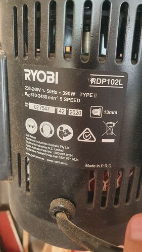

Hi @AnitaP,
If you can provide the model number of your machine, I can then contact Ryobi to see if a spare part is available. Alternatively, if this machine is still under warranty, you can return it to your closest store with proof of purchase, and the team can look at swapping the whole machine over for you.
You should find the model number on an identification sticker on the machine.

Thank you @MitchellMc that would be very helpful. Is this It?

@AnitaP,
It's a pity the store is so far away from you.
That cracked part appears to be included in the eye shield assembly pictured below and labelled 710. The part number for all those pieces is 089091005710, and it is reasonably priced. I believe this specific part is labelled #79, though it is not sold separately.
If this machine was purchased after June 2017, it has a four-year warranty and if you have your proof of purchase, I would be taking advantage of that and swapping the machine over.
Please let me know if you have any questions.
