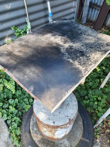

"I cannot remember the name of the board"
You senile old man. ![]()
FORMPLY
https://www.bunnings.com.au/formrite-formply-1200-x-595mm-17mm_p0390167
Welcome to the Bunnings Workshop community @kanchan87. It's sensational to have you join us, and many thanks for your question about shelving boards.
We do have moisture resistant particle board, but I'm loving @Noyade's suggestion of Formply. Formply is structurally more sound and is weather resistant. It's actually weatherproof on the front surfaces as it is coated. This coating is robust and will make it exceptionally easy to slide heavy objects onto and off the shelves as it's smooth. If you paint the edges of the Formply, it will be completely resistant to mould and water penetration.
