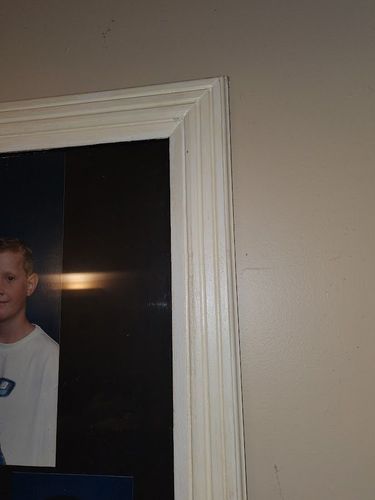

Good evening @shev. What wood are you using? Dave's suggestion above with the mouldings is a very good idea. But with just a router you can perform some magic. This a picture frame from a skirting board passed through a router with various shaped bits and a router table will make it even easier. Both products (router and table) are very inexpensive these days.
Let us know what you do.
Cheers.
