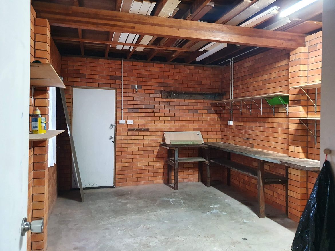

We are looking to convert the downstairs garage and utility space into a habitable room (bedroom, living, etc). The house is a late 1970s two-storey brick house in Queensland. The downstairs area has double brick walls and an original concrete slab.
Seeking advice on any DYI solutions to waterproof the double brick walls or make the concrete slab suitable for a habitable room.
Also interested in hearing from anyone who has undertaken a similar project. Thank you.

As soon as I saw your garage I thought of mine!
I have converted mine to a libary which could also be converted over to a workshop if I want to remove the bookcases.
Somethings I have found while renoing the garage.
1- Council rules, they arnt keen as to a garage become a room. Mostly because teh space for a car is then pushed outside and that space is pushed out onto the rd and then parking starts to become an issue (yes I did ask my local council
Its not a NO but a reasoning.
2- Garage floors slope towards the front
lol and mine was a drop of 10cm over 5m
3 - Walls are not watertight, I have a single brick wall that was always dry until It wasnt. I ended up having to seal the outside of the bricks and fix the water issue there. There are always fine cracks in bricks/mortar.
4 - Services need to be worked out. Gas point/electricity and how they will run.
5 - False ceilings needed or not? your choice but there may be some adjustment needed with your rafters. (I left my exposed rafters as I really like the look)
