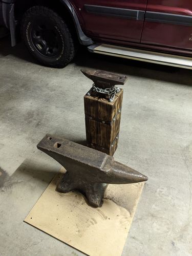

A couple of weeks ago, I picked up a little anvil for a very reasonable price off Facebook Marketplace. Now while I had no immediate need for an anvil in the garage, if you love tools, you probably love anvils too
Naturally an anvil needs to sit on a sturdy base and I didn't just want to settle for the old tree stump solution. I wanted something epic, preferably medieval looking with a mix of charred wood and bare steel.
So I started off with a 100x100x2400 timber post that I cut in 4 and glued together to create the 200x200x600 blank to work from. I used a power planer to get the sides relatively flush without completely ruining it's rugged looks, and also threw a bevel on the edges while I was at it. I traced the anvil's footprint and used my router to drop it by about 10mm so that the anvil sat nice and snug and couldn't slide around. I also used the router to create 2x 25x3mm channels around the base, 150mm from the top and bottom ends.
Once I was happy with the shape and size, I used a blowtorch to char the exterior and really bring out the wood grain, followed by a quick Scotchbrite scuffing to blend it nicely. I sealed the charred base with two layers of boiled Linseed oil.
Finally, I created the 2x metal straps that fit snugly in the channels I had milled, welded the ends and drove 16x 45mm coach screws through it to bring it all together. Overall, I'm super happy with the outcome. The last step will be to add the tool holder to the top and secure the anvil with some brackets that I'm yet to make ![]()

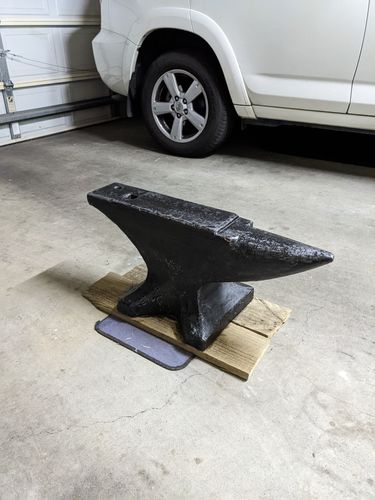

I picked up a slightly larger anvil today... The small one will now be sold to fund the next anvil base which I predict to be a ripper!

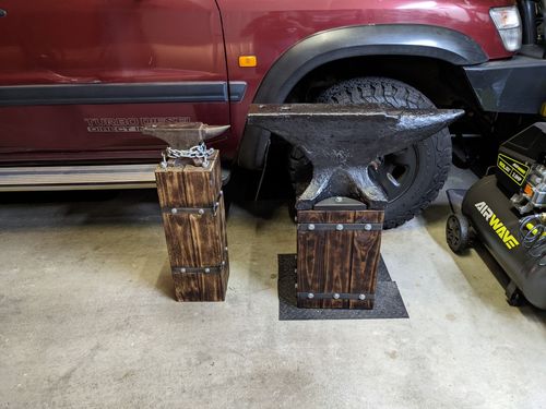

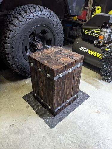

Been a bit of a hectic week consisting of prepping the new anvil and building it a base but were getting there... I decided to make it a bit darker this time around to better suit its 19th century tenant...
Stay tuned for the final product coming soon!
Hi @MartiPedia
That looks absolutely amazing and now that you've doubled the thickness of the base, it looks ready for some heavy-duty use. I'm sure our members are keen to see the finished product once you mount the anvil in place.

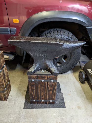

Well, wait no more! Here she is!
The sheer weight of the new one negated the need for noteworthy engineering in terms of attaching it to the base, with the blocks that I bolted down on top merely following the contour of the foot to secure it's orientation on the base.
What a brute, @MartiPedia! Are you using the anvil for blacksmithing or just for the ability to beat on things at a whim?
I'm certainly interested in blacksmithing as a hobby and can definitely find use for a forge in my workshop, but for the moment it's simply a hard surface to force things into submission upon during my everyday DIY and crafting endeavours

They both look fantastic.
But...
To my eyes the first (smaller) anvil/support looks better - possibly the proportions just look right.
Yeah the size of the new anvil's base is slightly too small for its footprint but the challenge is that because its so massive, achieving the same look as the small one would have required 16x 100x100x450 posts to put the saddle at the correct height, which would have exponentially increased both the weight and cost of the resulting base and given that it's purely a hobby commission for myself and not something I plan on selling anytime soon, I had to operate within parameters that made sense from that perspective.
But totally agree, a cube (450x450x450) would have been perfect! Next time 😉 For now, I need to get a forge up and running!
