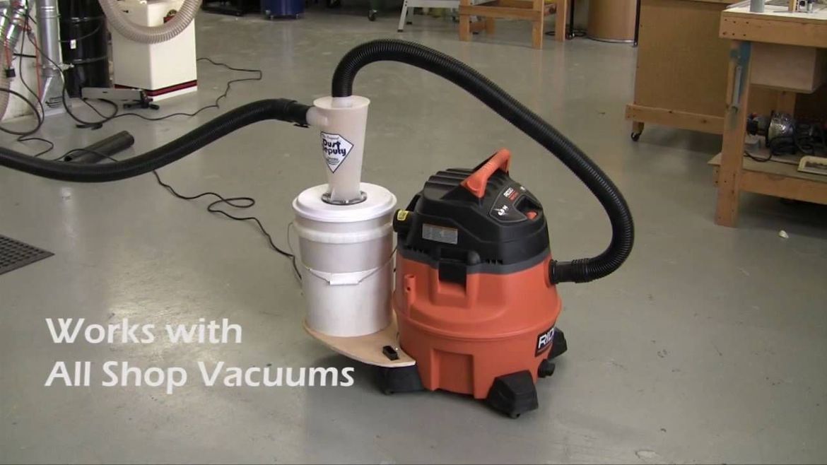

If you are working a lot with MDF then the dust is very fine and will clog a Shop Vac filter very quickly but you could add a "Dust Deputy" Cyclone bucket which will catch 90% or more of the dust before getting to the Shop Vac.
This would be my recommendation if you are trying to get away on a budget.

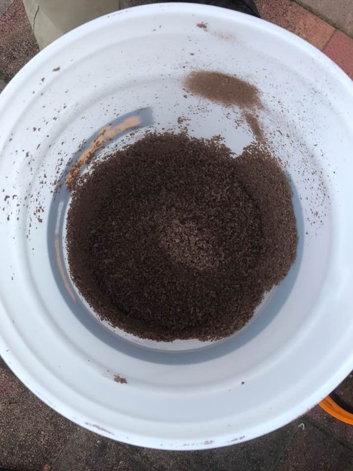

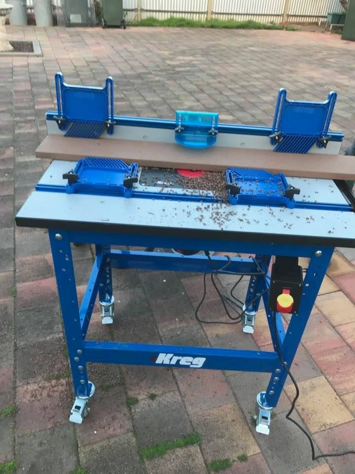

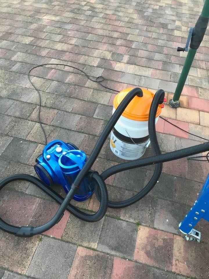

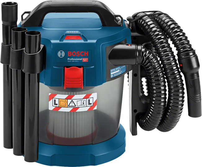

20729481_10212161548148025_2057371136874550894_n.jpg20729399_10212161547948020_6762315297998361216_n.jpg20767804_10212161548468033_6678966514939317084_n.jpgcordless-dust-extractor-cordless-wetdry-dust-extractor-gas-18v-10-l-professional-143842-143842.png
For most things I have https://www.bigw.com.au/product/contempo-bagless-vacuum-cleaner/p/8389359/ and https://www.carbatec.com.au/triton-dust-collector as it has 2 inlets for when I use the Kreg router table, the connection to the table is not an artisic thing but it sort of works and for everything else so far there is https://www.carbatec.com.au/rockler-small-port-dust-right-starter-kit.
I got the Bosch for when there is no power handy, not because I got the t-shirt and free battery... needs wheels though.
