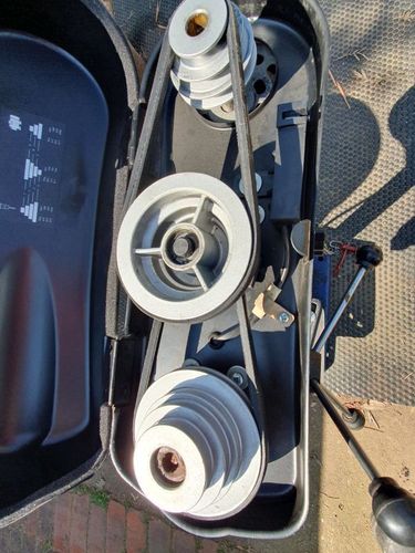

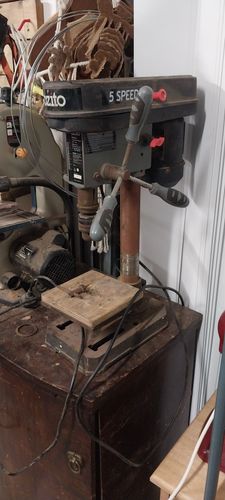

Need a replacement belt and manual for this old ozito drill press. Can anyone help

If Eric has no success with Ozito - I have taken old belts to engineering outlets (BSC for example) and they have found a matching replacement.
Or is there no belt at all with the drill press?

I apologise, but as that drill press was last sold in 2010, the drive belt is no longer available as a spare part from Ozito. I did manage to track down the manual for it and have emailed it to you.

this will be the next place I go. I tried a few bursons outlets to find a match but without luck.
There is no belt that came with it. But operates well. Some TLC and a new belt and it will be good to use.

I had a very interesting day yesterday trying to replace my generic belts.
Not as easy as I thought.

Small to medium and some floor model drill presses have been made for decades by countless brands using the same components just with different skins like colours and slight variations to cover shapes. So it's highly likely that many parts including V-belts are interchangeable which could make for a starting point when actual spare part ones can't be sourced. Ozito - Ryobi - Detroit (Total Tools) - Bayer & ITM (Sydney Tools) - Sherwood (Timbercon) - Carbatec are all Chinese copies of each other and many others.

Yes I did search around. And got taken from tool shop to auto shop to plumb warehouse. But found the belt I needed at BSC in Beresfield. They had huge range of belts. I took my press in and got it fitted. Hope this helps you and everyone else
Yeah it took a while but I eventually found a supplier of belts with a good range and had my press fitted.
BSC in Beresfield has a range there.

On Monday I presented to BSC with a generic Taiwanese belt (seen below) and they refused to serve me based on logic that they had no intention of trying to match an inferior product. I was just hoping you didn't have the same experience.
I've never had this happen before.
I walked out empty handed.
In the end I went to a local engineering shop that had no such qualms and walked away with two Gates belts of very good quality.
They're so good in fact I can now drill plate without a pilot hole with a 16mm drill bit. I could never have done this even when the drill-press was fresh outta the box 12 years ago. They fit better, look stronger and excessive tension no longer required.

What size, code and brand - belt were you given for the Ozito?
I have a similar sized 1998 Ryobi drill press I want to perform a Lazarus on and give to my eldest son. It too is a 2 pulley, 5 speed little unit.
