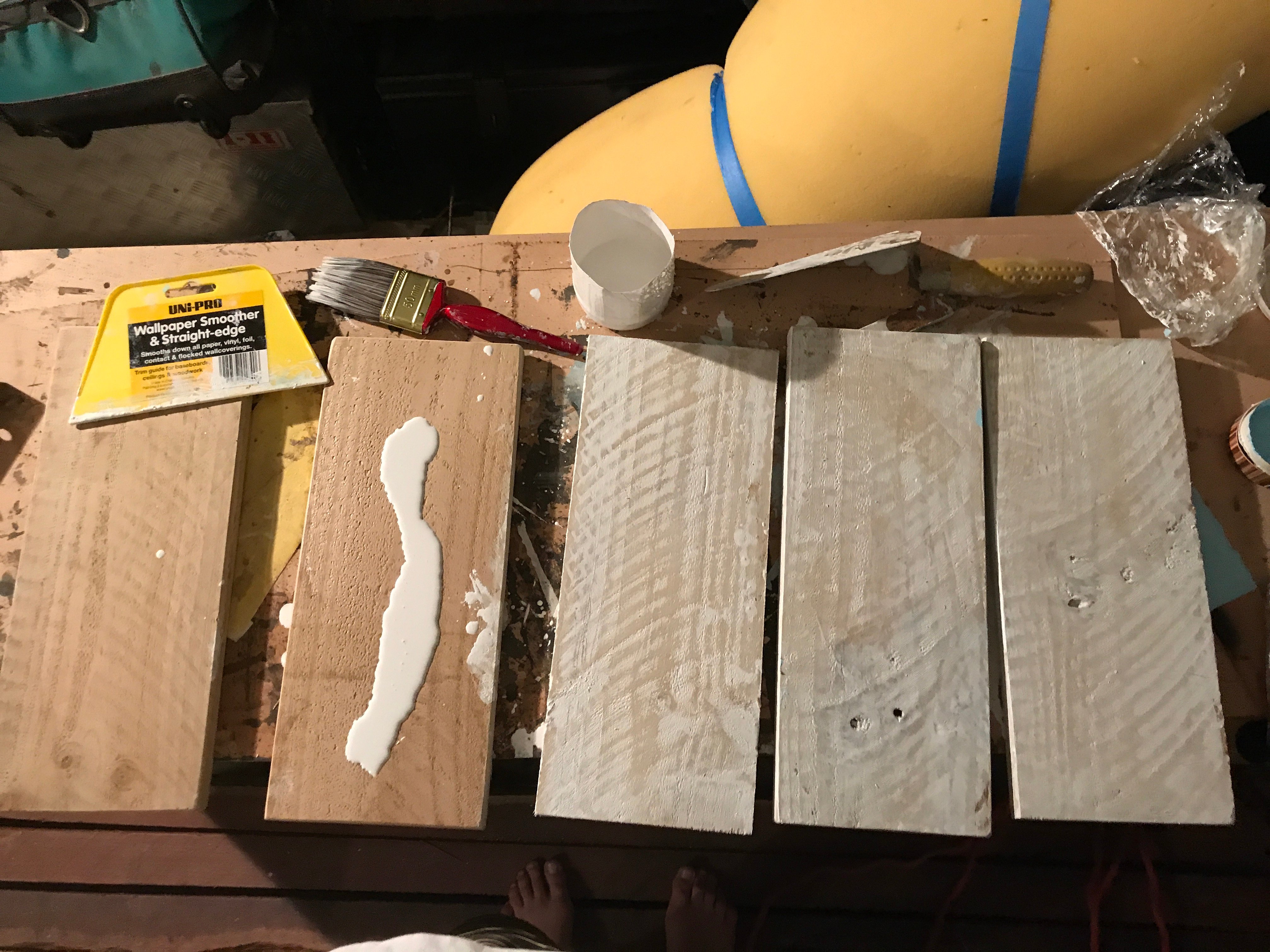

thought I'd share one way of creating a white wash beach look on wood/Pallet wood. I did water down some white paint that I had for the house, and used a scraper to spread the paint until I get this look,
What are some other ways? Of interpreting other colours like blue and black for giving a washed look White Wash

For people who aren't very bright like me, could you please explain a little further about the process is that you used?
Was it just watering down paint then using a scraper to apply. That's it? How much water did you add? And what type of paint? And just one coat?

@Kermit  please dont  say your not bright, hearing a new process & Imagining can be hard. I learn by visual examles, you can google ' paint whitewashing" and w as watch it on Youtube. It's.as easy as the writer states. Its trial & error, using scrap wood, dilute paint, wipe ofd with a cloth. The colour comes out even better with wax or sealer.
So glad I discovered this site, we get ideas then research more.  Thank you for for your time. Thank gosh for editing.
