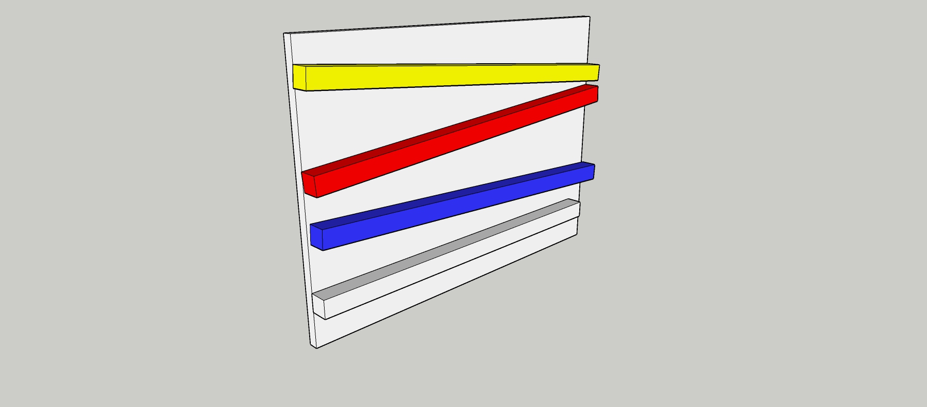

I've drawn up a sample sketch on how it might be assembled together. But because there are no measurements to base it on, I can only guess as to its actual size. The ball rails will be attached to the Perspex with either glue or screws. Once they are attached, the other panels are placed around it to close the device. But as I mentioned, I've no idea how the spring-loaded device is assembled.
