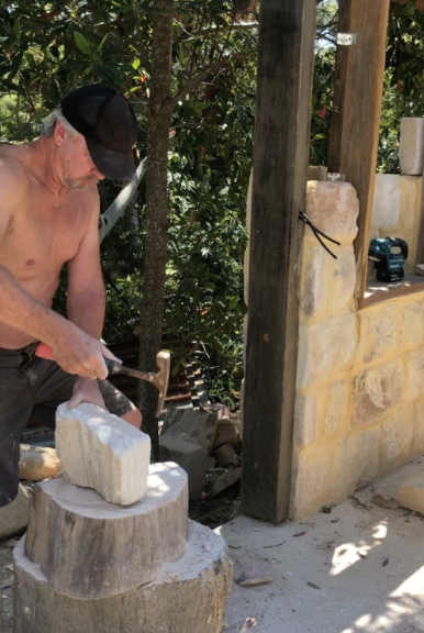

Did you shape these blocks yourself from raw sandstone, or was the guy digging out the blocks? I'm already astounded by your craftmanship, but I can't even imagine the amount of work needed to shape those blocks.

Thanks for your interest and compliments. The blocks are sawn out of a solid shelf of rock, so if you could imagine a sandstone floor (under a house) into which a grid of saw cuts is sawn into with a petrol saw. to a depth of about 200mm, then the blocks are busted out with a pry bar. What you end up with is a pretty ugly block, some break out with a decent face but 80% of them need to be shaped or at least dressed to look traditional, some take 20mins or so (probably 1000 blows) to give the hand hewn look . I used a fossickers hammer with a chisel shaped point to chip away so that there was no sawn edges visible. Yes it was very time consuming and not something I would have attempted without the luxury of time that Covid lockdown gifted us.

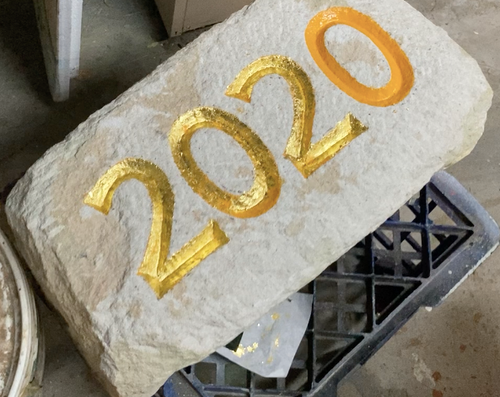

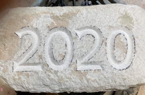

Thank you,,,I do enjoy it, "a lot", every where I go I'm looking at stone, lol, I even tried this while I off with Covid. As part of the barn... Regards, BB

What tools did you use for "2020" - ?
The numbers even have a perfect looking centre line - in the cavity?

I don't know if you saw, but I am a signwriter so lettering is my thing. I drew it on with a pencil, then I roughly drilled along the centre line of each stroke with a 6mm masonry drill, this gave me something to chip towards, So then it was just a matter of using a small flat cold chisel, going around chipping from the pencil line in towards the centre creating the 'V" shape as you go. To be totally honest I was blown away by how easy it was. it only took about 20 mins per letter, which is a bit long, but when you know it's going to last 200 years it's nothing right?. Thanks for your interest,,,give it a try,,,regards,,, Brad
