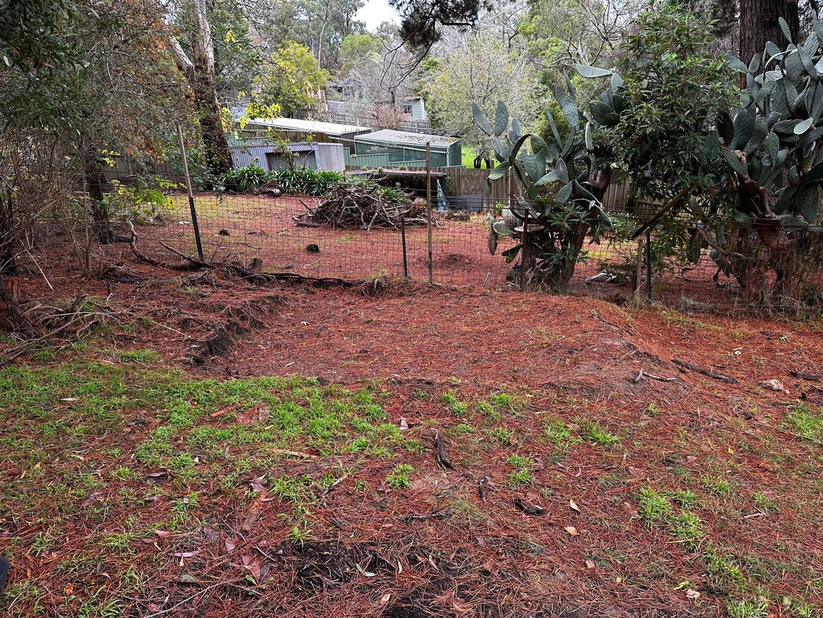

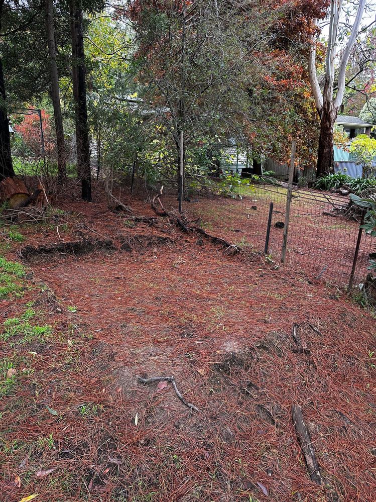

Hello all! I am planning to build a small wooden storage shed as a project to gain some carpentry skills. It will be approx 3.5m wide x 2.5m long (Staying under the limits of permit requirements where I am in Victoria). I am on a sloping block and have had a small area cut into the slope, and one side built up to level it by an excavator (See attached images).
Essentially, the built-up side is quite soft so I don't think I should use the concrete foundation blocks that are often recommended.

Front view, area to be potentially retained on the left
Side view

You have a couple of issues here. Your ground not only slopes left to right but from front to back. The slope is effectively on a diagonal to your proposed location. Secondarily, instead of digging down to establish a flat plane, you've added soil from the left-hand side to the right to minimise the depth you had to dig. I don't blame you; it's hard work. So, now we have piled up loose soil on the right and back of the proposed shed area.

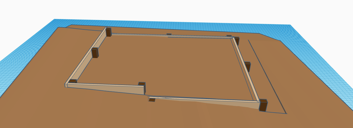

You need to retain the soil on all four sides before compacting the central area. I've created a rendering below to illustrate. The sleepers on the right and at the back stop the soil from failing away down the slope, and the sleepers on the left and front stop the soil from slipping down the slope and into the shed's footprint.
Once you've stabilised all four sides and compacted the retained soil, you're free to create whichever style of base you'd like. The key issue is stabilising the ground. Without the soil being adequately retained you can't compact the area; without compaction, nothing will be stable, whether that's a gravel, concrete or timber base. Any compaction you do without the retaining walls will cause the soil to slip down the slope.
Get the base right, and you'll be ready to use whatever footers/base you like. I'd recommend adding 100mm of gravel, compacting the area, and then using DEKO 250 x 150 x 150mm Instant Concrete Foundation Blocks with your timber frame on top.
Crikey that is an excellent point @MitchellMc! I'll start here. Is there a standard sleeper depth you would recommend? 75mm? And what would you use for the posts to secure it in place? Is there something less effort than the proper steel brackets used for retaining walls concreted in place?
