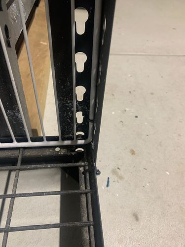

Any recommendations for heavy duty wheels for this workbench that will be compatible with it

I will be moving, this bench, back-and-forth a lot so I need some wheels that can handle a good amount of weight and can handle being pushed back forward
Hi @ethan18,
As @TedBear has touched on, altering the design of this storage rack by adding wheels will throw off its weight-bearing characteristics and stability. This style of storage shelf is not designed to have wheels added to it. I have safety concerns with this idea, especially if the rack will be carrying a good amount of weight. Due to the locking mechanisms, you couldn't attach wheels to the bottom shelf as it would raise it, and the locking pins would disengage. That would only leave you with the uprights to attach wheels onto and I don't believe there's enough material to attach heady-duty wheels to there.
If you are after a moving shelving unit, I recommend investing in one that comes fitted with wheels, such as the Montgomery Chrome 6 Tier Wire Metal Shelving Unit With Wheels. This shelving unit is capable of holding up to 65kg per shelf. If you are after a more heavy-duty system, I suggest using the Rack-It products and their compatible Rack It 1000kg Workbench Castors - 4 Pack
The shelf I was going to move up I can add some wood to the bottom as extra bracing if needed
How tall is this workbench/shelving unit @ethan18? If it is wider and longer than it is tall, you could consider your idea as it wouldn't be a toppling risk. However, I strongly advise using an existing unit with wheels that is designed for that purpose. You'll find our range of castor wheels on the Bunnings website and they'll list their weight capacities.
