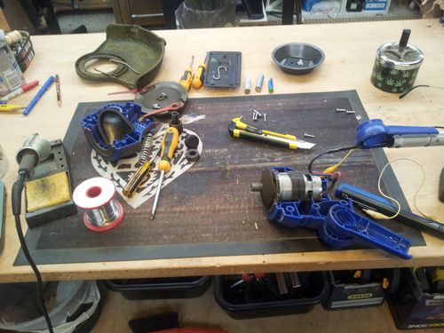

One reason for the long service life is that like many DIY's I can repair stuff.
487241420_10237260520195241_4377030104082284043_n.jpg.

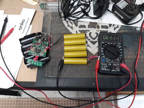

A common fault is that one of the cells (batteries) will die and needs replacement.
A battery pack usually has 5 x 18680 Li-ion batteries each with a nominal voltage of 3.7 volts (5 x 3.7 = 18.5 volts).
Another fault which effected both the blade trimmers due to vibration was a broken motor connection.
