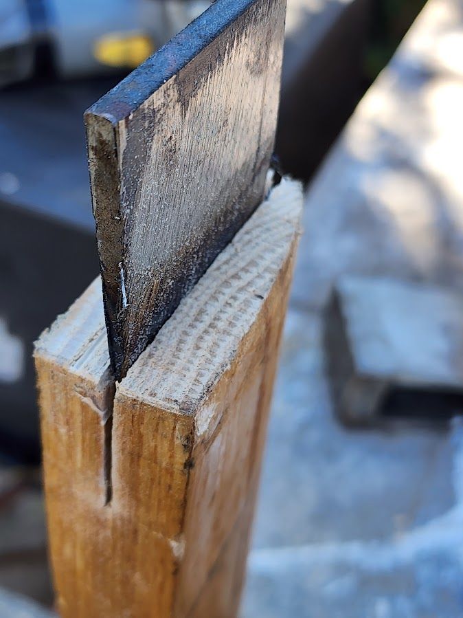

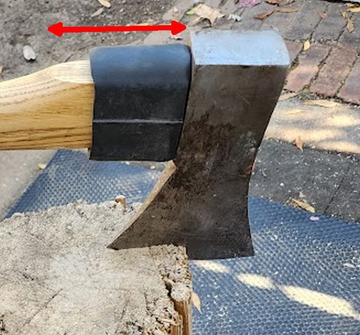

Without having to go to Bunnings, is there a way of finding out the end profile (and dimensions) of the two replacement wood axe handles available in store?

I spoke with some colleagues in store who have informed me that the 800mm Australian Hardwood Replacement Axe Handle is oval shaped and is roughly 58mm tall and tapers from around 11mm at one end to 19mm at the other end, so this probably isn't what you're after.
It sounds like the 800mm Trojan Replacement Axe Handle With Wedge is closer to your shape and dimensions although they've said the top is closer to 20mm than 25mm. I imagine with the wedge installed it would expand closer to the dimensions you are after.

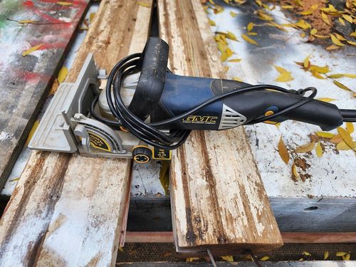

I saw two Ryobi biscuit cutting blades on clearance at half price.
I have an old GMC cutter with a blunt blade and wondered if the Ryobi's would fit.
Purchased them and rushed home. I forgot all about the axe handle.
I'm thrilled though - the blade fits perfectly!

I eventually did get there.
And yes @JacobZ  the 25 mm was the full width of the axe opening.

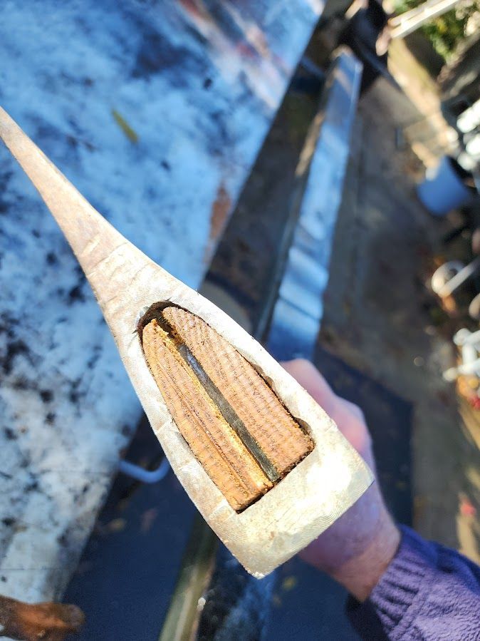

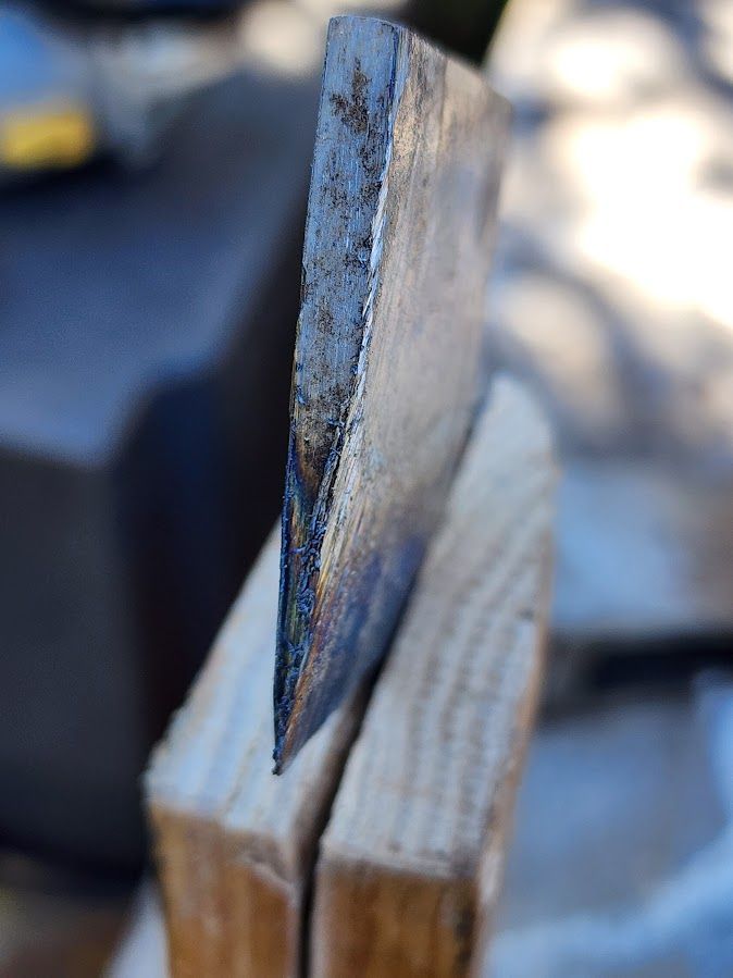

But in the end I walked out 'handleless'.
I decided to move the head back. It was originally held in place with some sort of Bakelite substance that had failed. No wedge.
I cut it back 60 mm. Reinserted and well and truly wedged with a homemade steel wedge (50 mm X 50 mm) ground to a point with a 9" grinder.
If this fails - I'll re-examine the handle above.
