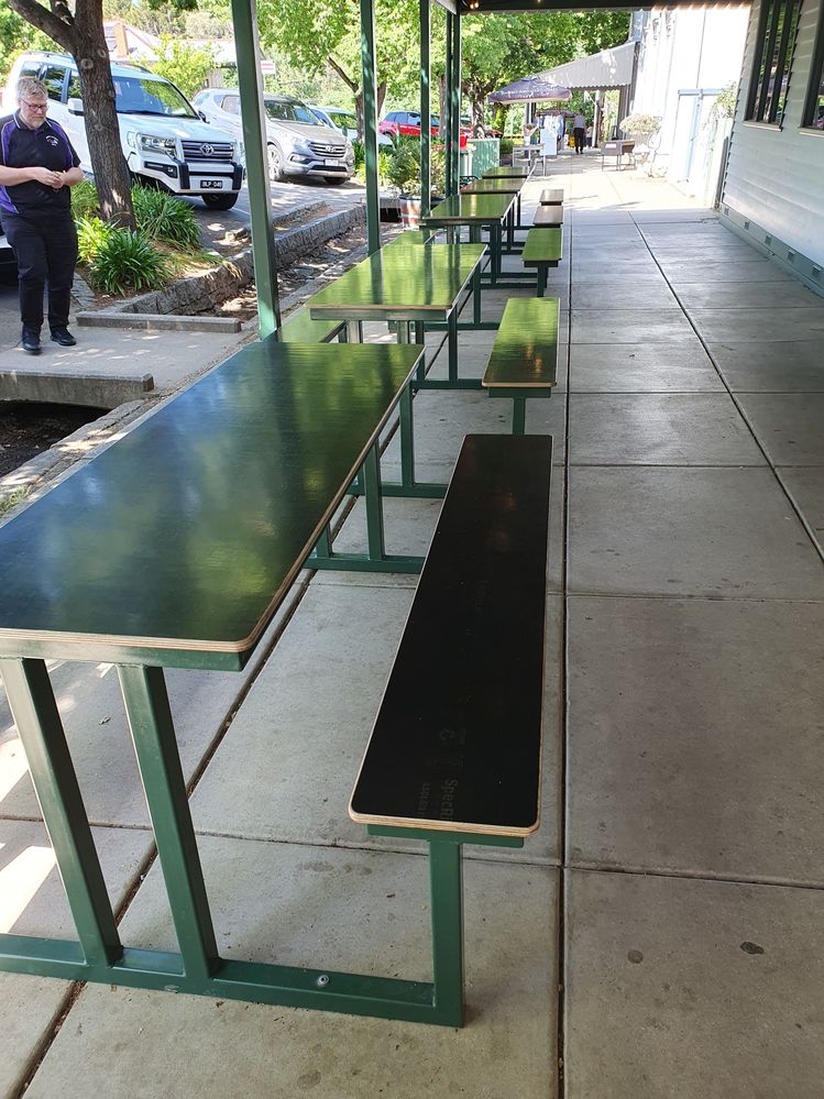

I like Bunnings Specrite Formply. Easy to work with and durable. I've had a sheet on an outside workbench for around five years exposed to the environment and it has stood up well.
https://www.bunnings.com.au/specrite-1800-x-1200mm-17mm-formply-f17_p0390220
I recently saw it used for seating benches outside a Yakandandah coffee shop....

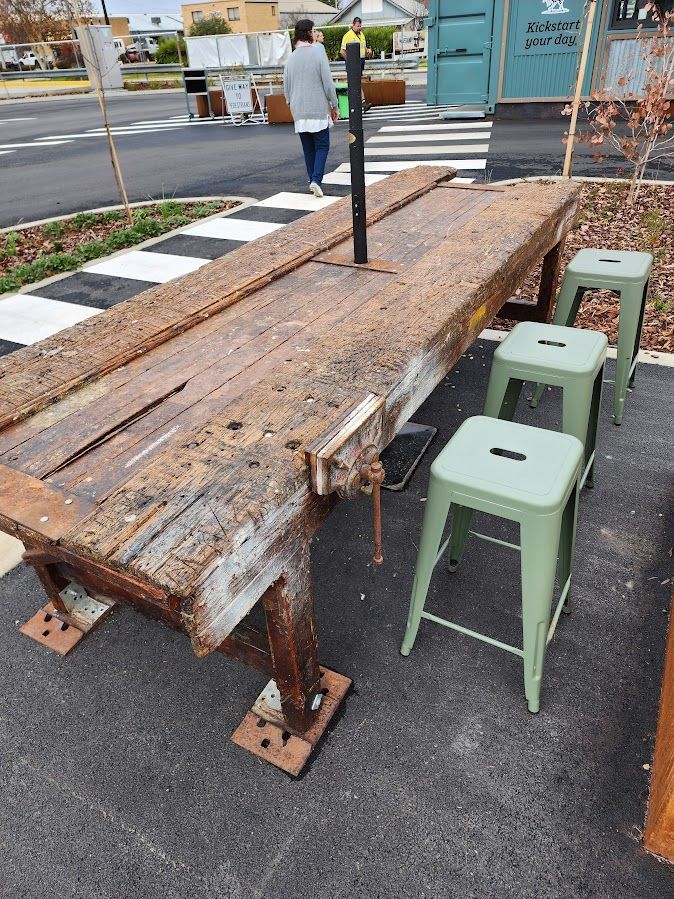

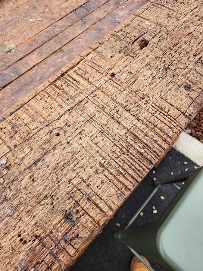

Just a bit of thread drift.
But I saw this outside a new coffee shop today. What a history it must have had!
It's now an outside bench for eating/drinking.
I asked the owner if they bring it in each evening. He said no.

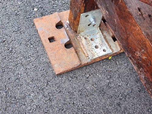

I mentioned that it wasn't secured down.
"That's OK, the security camera now has your licence plate - if it disappears I'll know who took it!"
