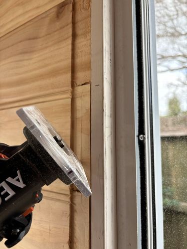

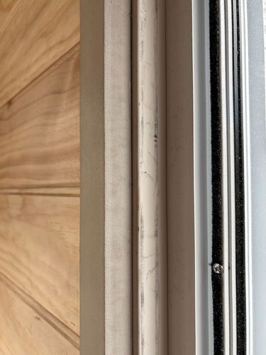

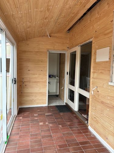

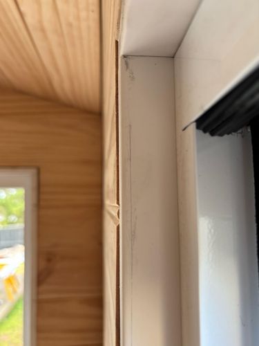

Nice score @Noyade trim routers are so handy 👌. I have a cordless one which really only gets used for hinge rebates in doors. But last year I had to overcome a last minute change of mind when the customer wanted to line the walls with thicker VJ boards. It took a lot of deliberation as to which way to handle the arcs for best finish. In the end I rebated all of them. It really put the trim router to the test as well as my frustration.
