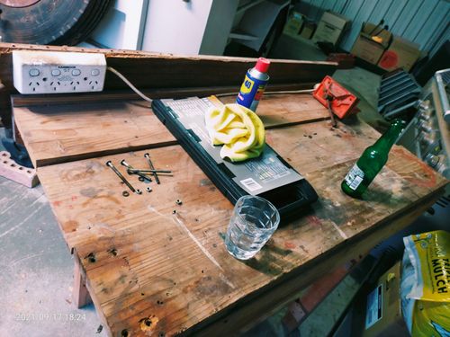

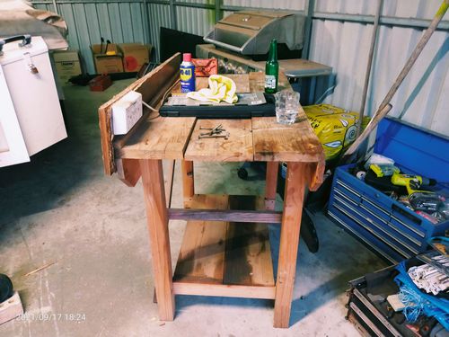

Hi @Wouldy
The workbench looks like it is still in very good condition. I suggest replacing the back panel that's holding the electrical outlet as it looks like there has been some water damage on it. I recommend giving the table a good sanding with an Ozito ¼ Sheet Orbital Sander. This will remove all the blemishes on the benchtop and bottom shelf. You can then apply a coat of Feast Watson 1L Clear Outdoor Furniture Oil to protect it from the elements.
Some of the features you can add to it are the Pinnacle 1810 x 540mm Matte Black Metal Pegboard to hold the tools that you often use. I recommend adding a shelf to hold the Handy Storage Systems for all the bits and pieces you use on your projects. I suggest adding Move It 75mm 50kg Black Rubber Swivel Plate Castor With Brake so you can keep your workbench mobile. The best add-on you can put on your new workbench is a Ledvance 60cm 6.5W 650lm Day Light LED Batten to illuminate your work area.

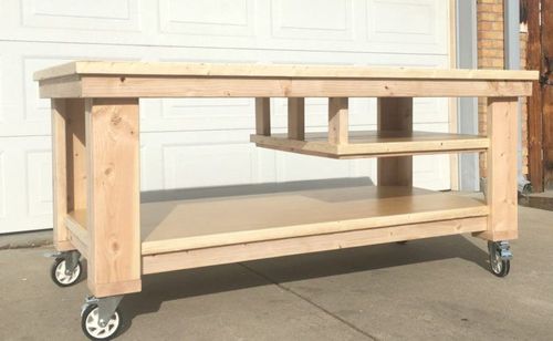

Please have a look at the drawing below and tell us what you think. If you wish to see it in another configuration, please let me know.

Hi Bit late with this but the current workbench looks like it could do with a bit of a makeover. It’s also looks like it could be moved around a bit. I would keep it and make a movable bench plus. The following suggestions will allow the use of the bench from both sides a lot of projects need that freedom of movement.
1 remove the back board with the power board on it and place the power board at one end under the top of the bench
2 a wood vice both sides but opposite corners to each other so you can work either side of the bench
3. a large wood vice at one end
4. a set of jacking wheels or casters for movement around the shed or movement out side to work This is just an example of a movable workbench
5 lay out a series of holes on the top for dog clamps as shown in photo
All these upgrades are subject to space of course.
