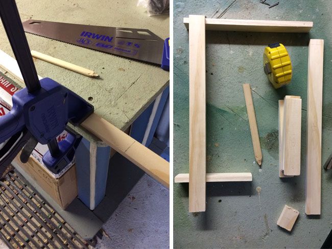

Measuring twice and cutting once didn’t take too long, and soon I had the pieces to build the front. Making sure I had a stable and firm grip on the timber allowed a quick and clean cut. Then it was time to assemble.

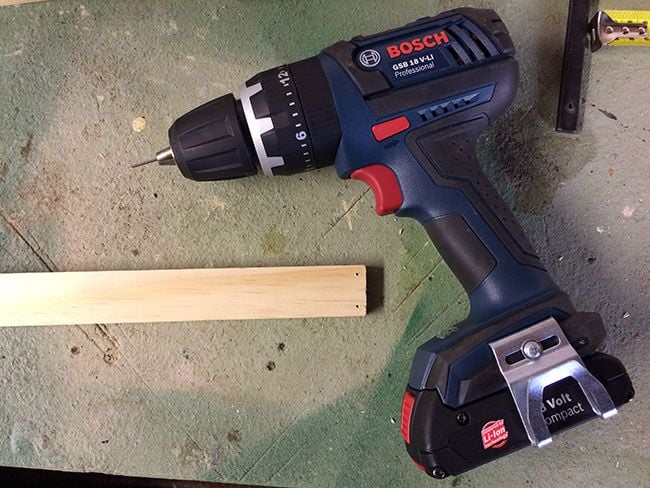

QUICK TIP: Use a nail as a tracer with a drill to make sure you don’t split the timber (Picked this up from Dad). This really helped with speed and accuracy when putting the frame together, especially when added with the wood glue to make a solid skeleton.

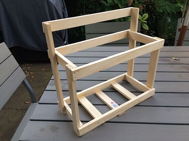

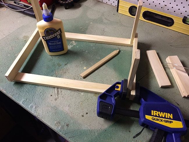

I put together the front and sides easily enough, along with the back which lined up nicely to the front elements which were built from the bottom up to make sure the pieces were lining up correctly. For structural support I also added some spacers on the bottom of the box, as this will also be what the records rest on.
Also using offcuts allowed the correct spacing to be applied when gluing and nailing the timber together, making a more effective join, and straighter!

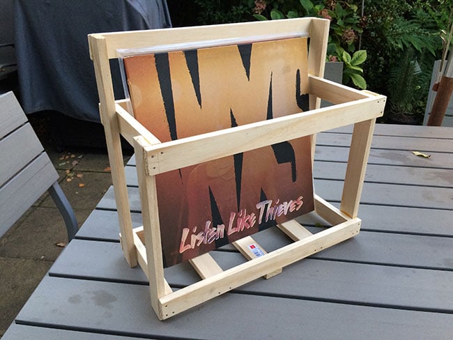

See below an image of the main box without the lid, which I’ll be working on next weekend with a bit more time, and I'll post some pics shortly.

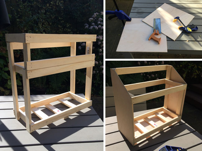

I finished off the 'lid' frame, and purchased some 4mm marine grade plywood to wrap it in. I'm sure I could have used something different, but I liked the finish and texture.
Having the right saws definitely helped, with the smaller hand saw having finer teeth allowing a cleaner cut of the plywood. A tip that I picked up was to score the plywood with a stanley knife, enough to have a clear line to follow, and this helped cut the plywood a lot more smoothly. I did have a little bit of wastage here as I was trying to cut too quickly on some pieces, but patience is the key here!
Also had to make sure I measured twice and cut once, as I had measured out the pieces needed from just the one piece of ply.
I started off with the glueing and nailing the base, using small brad nails to help affix the ply to the timber, and an improvised nail punch to finish it off with a cleaner finish. Next came the front and back of the actual box, making sure that there was enough glue over the frame and a bit of pressure to make sure it adhered properly.
The lid was next and applied the same startegy with this as with the box. Applied the top, sides then back and front, making sure each piece lined up correctly with the grain of the piece below to provide a cleaner finish. As you can see in the image above it has come together pretty well.
There will be a few bits that I need to clean up with some wood filler, and sand back some edges to even everything out as the frame wasn't 100% even (out by maybe 1-2mm in some places), but it's all part of the learning curve when making these sorts of things I suppose
