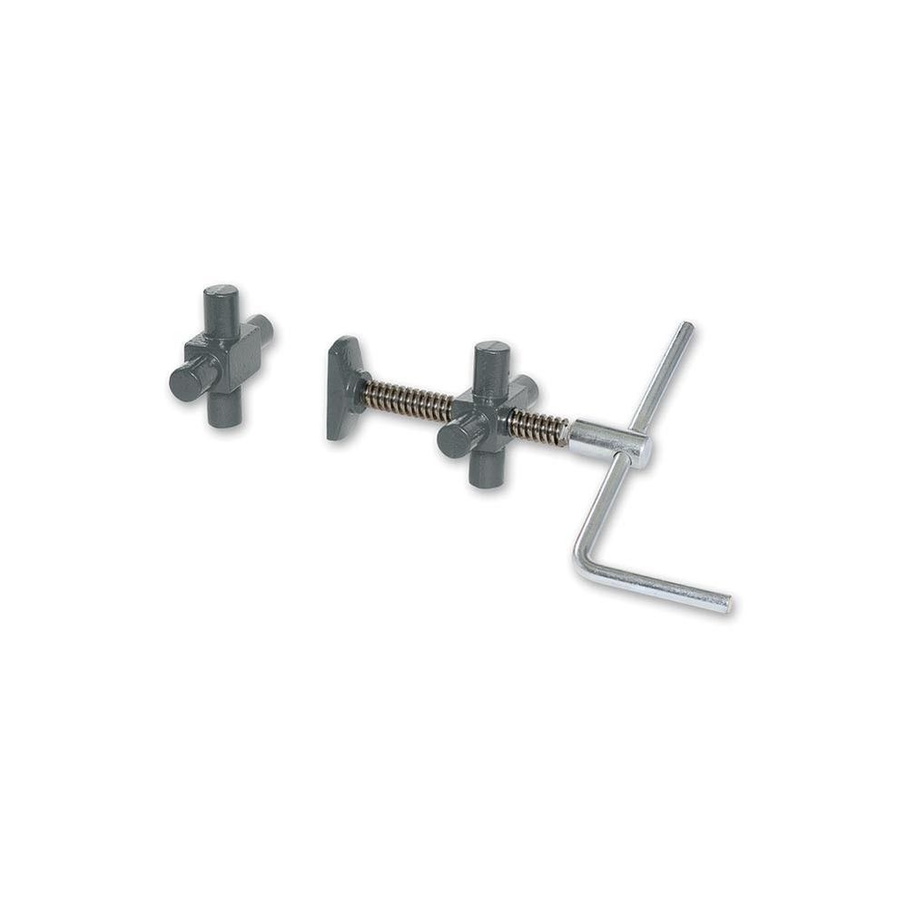

Veritas Panel ClampVeritas Panel ClampAxminster Panel ClampAxminster Panel Clamp
My similar clamp, I just need to drill the Aluminium RHS and the bench top in a 96mm hole pattern (As well as make the bench frame and drawers and the downdraft baffle) I think the pins being undersized is what pulls the rails into compressing on the face, I think your style of clamp would put more pressure on the face.
