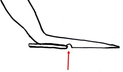

"Does anyone know if I can get something like this at Bunnings"
No - only the Mumme Reno bar which you illustrated - and which I would not recommend, especially for very "tough" pallets.
I'm no engineer, but for some reason Mumme rebated the metal prongs to fit a piece of metal plate (grooved to remove nails) and as a result there is a small "gap" at the front, reducing the thickness of the prongs.  This is the point where they bend under stress. I bent mine on the first go - and returned it for a refund.

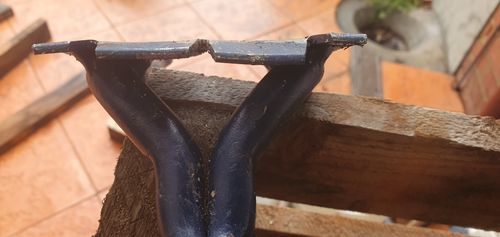

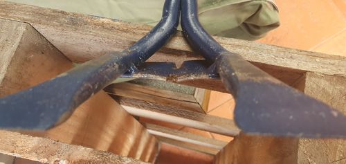

Re: pallet bar
I cant recommend the Mumme reno bar it seems pretty average at best. I Just bought it an hour ago and have tried to break up only 3 pallets. The nail plate at the base is not strong enough and is just bends when levering the boards and when attempting to pull out nails. I have had to alternate how I am levering the boards and nails just to stop that nail plate / leverage plate from destroying itself.  If I had time now I would be heading back for a refund but that will have to wait for tomorrow.
The images below are after alternating some nail pulling from front to back so the pics don't show how bad it bends.

Welcome to the Bunnings Workshop community @Woodster. It's great to have you join us and many thanks for your feedback on the product.
I'm sorry to hear that you've had some issues with the Mumme reno bar. I'll pass it on to our Bunnings merchandise team as I trust they'll want to get this sorted as soon as possible.
Your detailed description of the fault and the images will be helpful in Mumme identifying the issue.
