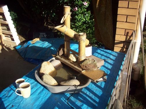

Step 3
Doing the full mockup thing to test the system.
Two coffee mugs means the boss lady is out for formal inspection and sign-off on the project.

I've always wanted to make one of these @AlanM52, but never got around to doing it. You've done a fantastic job!
Question, do the moving parts just slide against each other, and does the weight of the water overcome the resistance/friction? Any need to grease the joints?

@MitchellMc thanks for the nice comments.
The spout simply rocks (slides) on the bamboo cross support.
Cut the spout so the node is about middle (Blue arrow).
Bore the spout pivot holes just below the node.
The black lines indicate the amount of water (and weight) in the spout just before it pivots down.
If the centre of balance is such that the spout fills with water, pivots down and stays there we need to add weight to the other end - the bottom of the spout.
Wrap a pebble in chicken wire and stick it up the bottom end.
Check the balance again and if needed (likey) change to a larger or smaller pebble.
In my case I had to cut a foam disc and shove it to the bottom of the spout to reduce water weight - not sure why.
