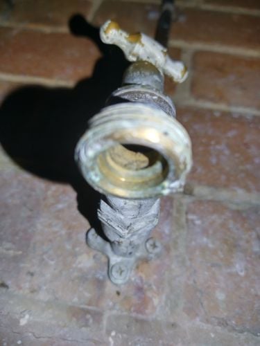

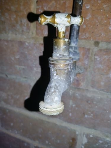

Hi, so I live in a small apartment with zero space for a washing machine, but tbh going to the laundromat is not working out, I hate it there.. So I want to get a washing machine and put it in my garage.
There is a tap located just outside the garage door I could use, but I just want to know if this is going to work out before I spend 2k on a washer/dryer.
The tap is a standard garden tap so I presume a hose will attach to it, idk, I have never gardened here as there is a lack of a garden to bother with. I put pics of said tap.
If this will work, I am wondering what other things I will be needing, like adaptors and such, I tried to look for youtube tutorials but I don't feel confident that I understood what they meant.
And is it okay to just have a cold water connection and leave the hot unconnected or will it not work? And when I'm not using the machine can I just disconnect the hose from the tap, as the tap is for other people too so I can't have it connected all the time.

Yes you can connect to that tap (although it could do with a wire brushing, or replacing. They aren't expensive to buy). I recommend that you fit a two-way outlet first (eg https://www.bunnings.com.au/holman-2-way-y-tap-outlet_p3120268) so you don't have to keep disconnecting it to use other hoses. Modern machines heat the water to the right temperature, so it is best not to connect them to your hot water supply anyway. (The machine supplier will explain why.) Be sure to get a burst sensing hose fitting if you are likely to leave the machine unattended. If you are buying new machine, it should come with one anyway. The other thing to consider is where the machine's water outlet will go. Assuming there is no sink in the garage, you will need to provide a standpipe attached to a wall, to drop the outlet hose into and run it away to a drain. I hope that helps to add to the plan.

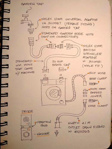

Welcome to Bunnings Workshop and thank you for sharing your query with the community. Yes you can attach your washer to the tap. I've attached a sketch on how to go about it. Just a few reminders before doing this.
All fittings must be secure and firm before turning on water.
Some machines make their own hot water like LG. So choose your machine wisely.
I suggest getting a stand alone washer and dryer. Why? When one breaks down it won't take the whole unit with it. Place the dryer on top of the washer if you are tight on space. Use thick vibration pads from Bunnings to protect the washer.
Make sure your exit hose is at the correct height or at the same height as the washing machine. This prevents auto siphoning and overheating the motor.
The water from your washer can go directly to the grass so as not to waste it.
Questions? Show the picture to the Bunnings plumbing specialist to confirm your purchase or post them here and we will try to answer as best we can. Please post your progress so that others who are in a similar situation can see what you've done.
Cheers
Red

@redracer01 Wow, thanks so much for the detailed picture, really appreciate it.

Again, thanks for taking the time to draw me a picture, so helpful!
