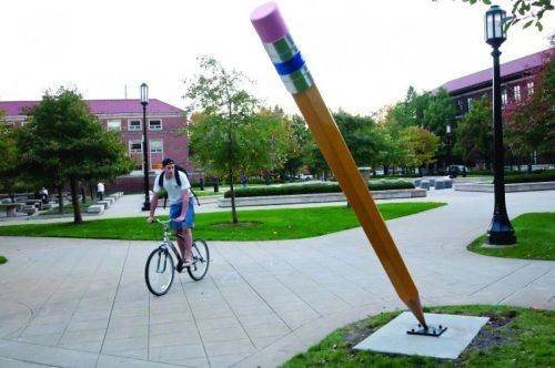

First time poster here. I was wondering if somebody how any idea how i could make one of these outdoor pencil sculptures that i could concrete into the ground. I'm just not sure how they even were able to cut these and if bunnings sells the correct type of wood for something like this.

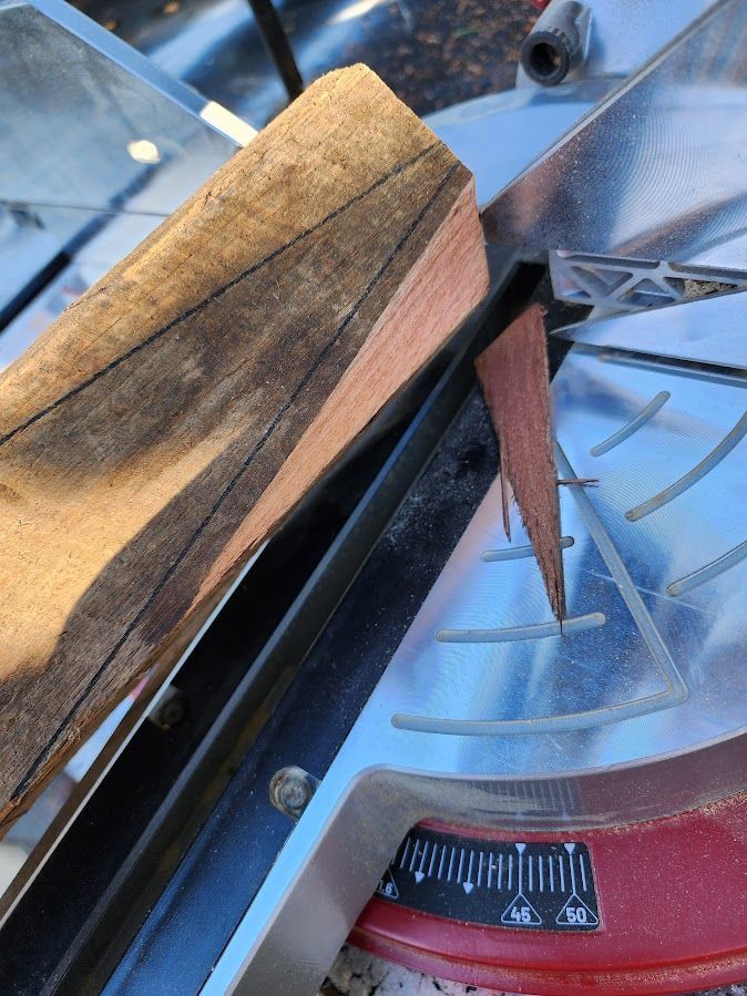

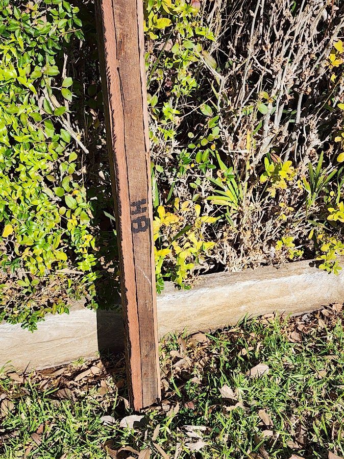

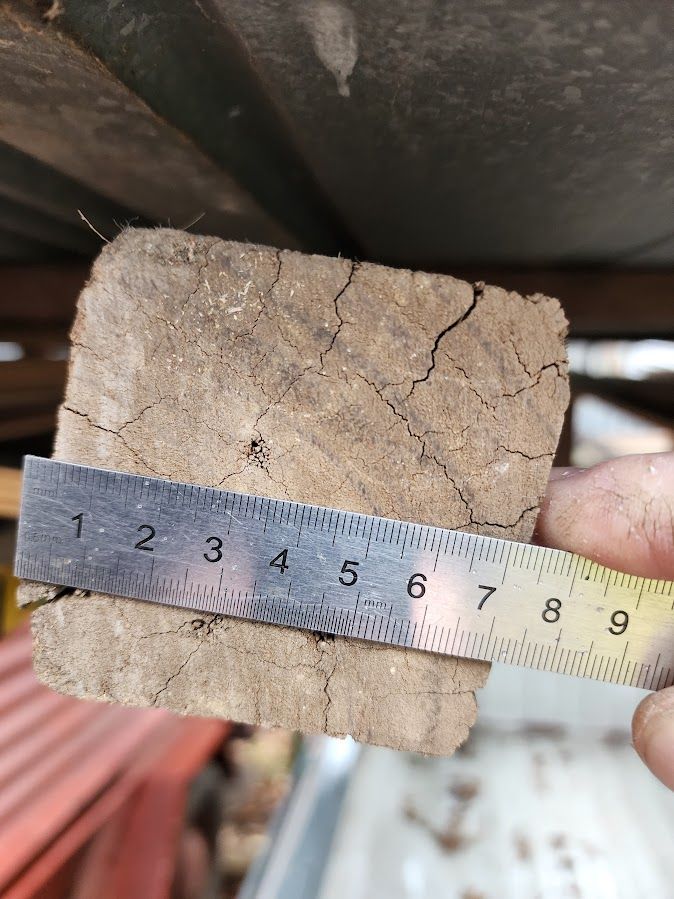

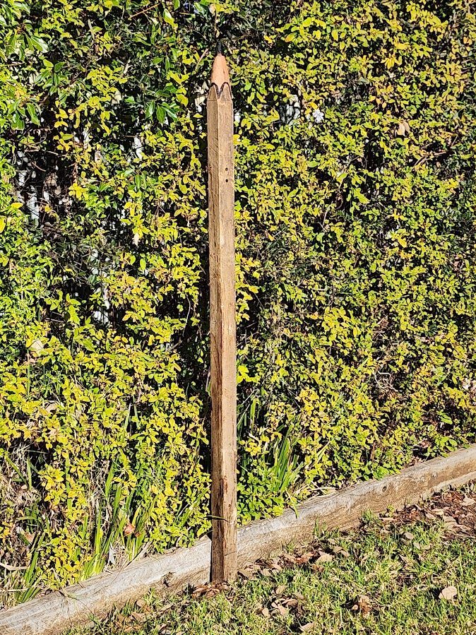

Much better day outside so I thought I'd give this a go. I was thinking of ripping the hexagon - but got things to do today, so I just went with the square beam.
Very old hardwood - probably was 3" square but now shrunk to 70mm square.

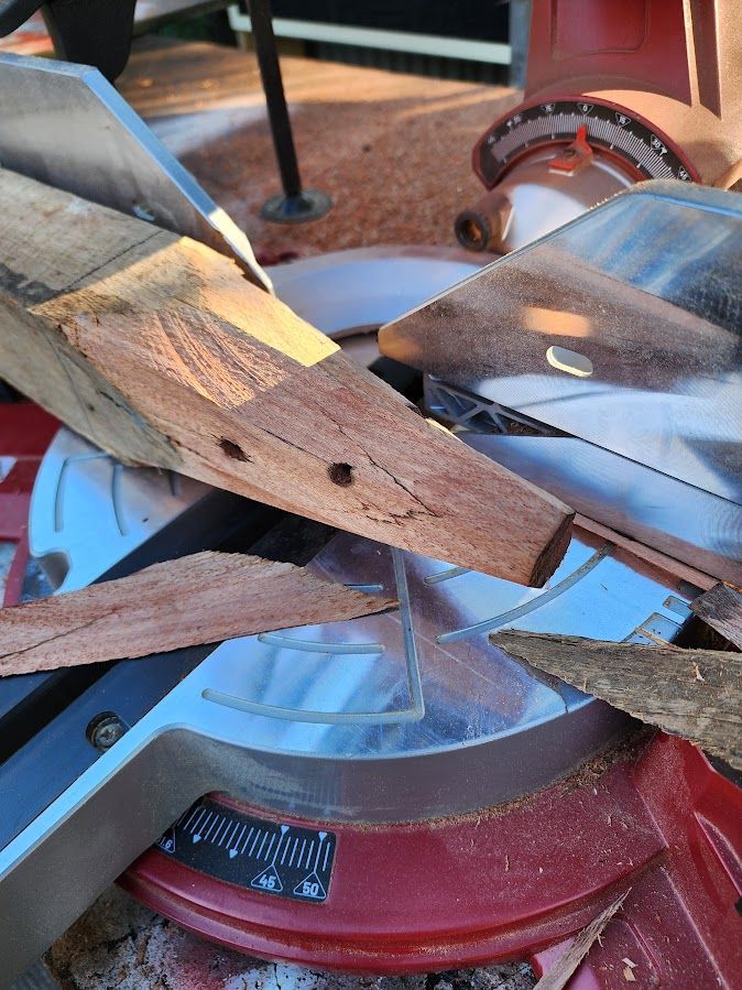

Just lots of angled cuts. Be brutal.
I have a 12" drop saw - so no sliding required.

Re: How can i make a wooden outdoor post shaped like a pencil that i can install into the ground

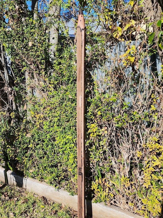

Finish up with a 6" sander - no need for finesse.
I still think it would look better with a hexagonal body.
"I still think it would look better with a hexagonal body."
On second thought - I don't think anyone would care or notice six sides compared to eight sides.
Rip the edges off.
Incorporate a metal covered eraser?  🤔😁

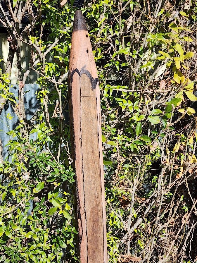

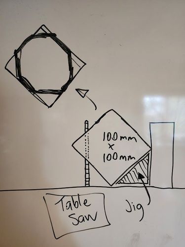

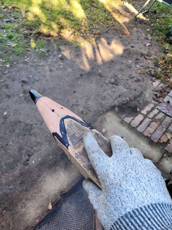

I eventually removed the corners with just a circular saw - roughly.
Then tried to delineate all the edges with texta.
But from a distance it doesn't seem to matter?
Now I just need to make a big hand...
