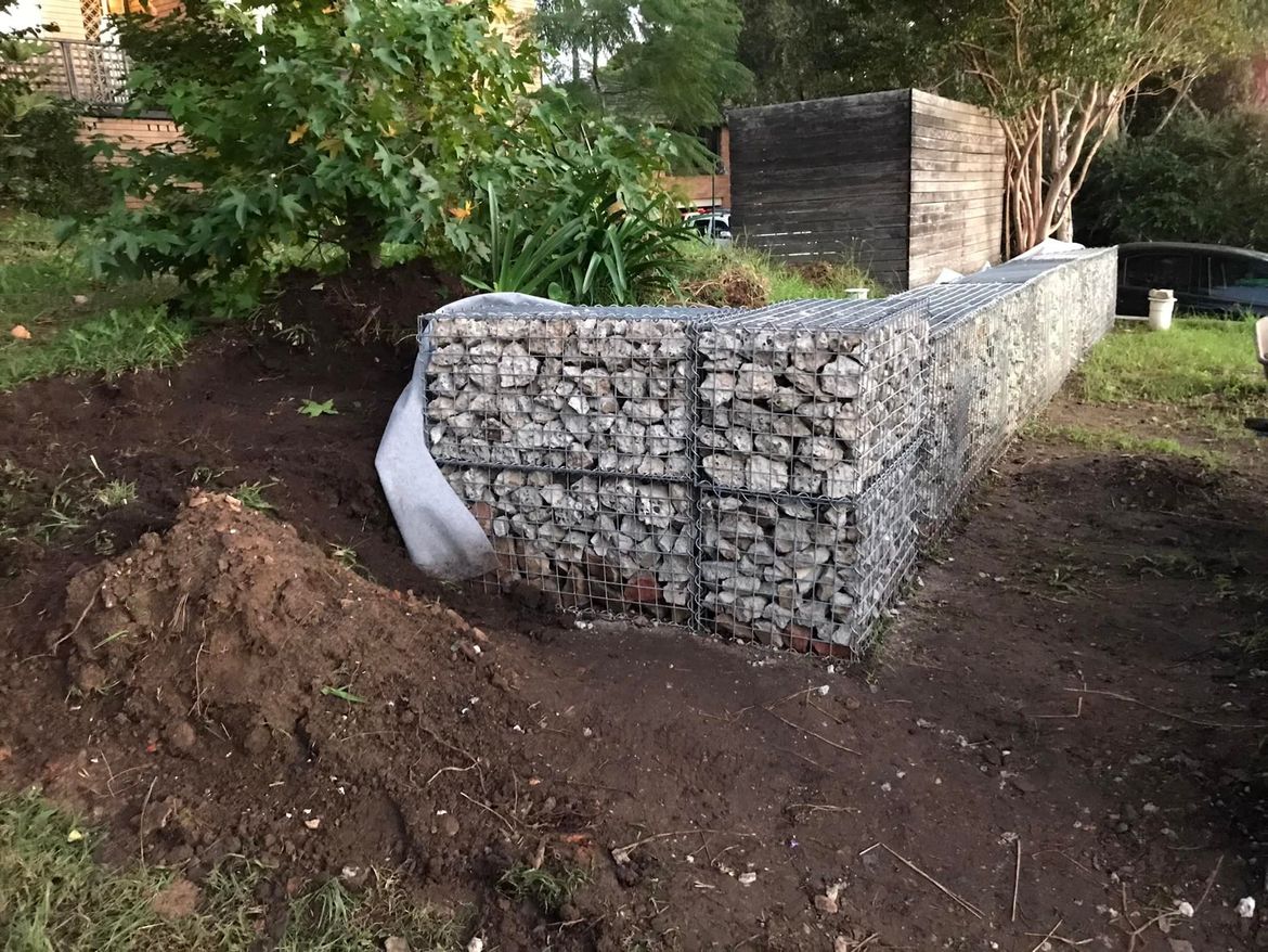

If you are thinking of a full rebuild then maybe Gabion baskets. Bunnings sells a few differant sizes and they work well (I have used them a fair bit) Just need stuff to fill the baskets. I have made some from scratch but ended up buying the premade ones for the corners. The Baskets are 400mm * 400mm * 800mm (If you go down the track I can give an idea on how to make them look level when you have a run of them.)

I really like the look of the gabion baskets, but they'd look too bulky for the relatively narrow garden this retaining wall is for.
Thanks for the suggestion though, I'm loving how this site brings out a variety of ideas, it's helping me make the best decision!
