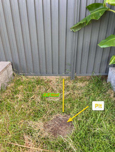

For a Garden shed, that fits in to the space as shown in below image, appreaciate any inputs on this subject. The requirements are as below
1. Storage of garden tools
2. Storage of Manure, soil, Mulch (around 3 X 25L each)
3. Couple of other items / parts associated with gardening.
4. Can that be mobile (Installing Wheels underneath) for cleaning the fence or at times when required.
5. Are there are blindspots which I have not looked at.
Should an off the shelf Garden Shed, be suitable, kindly ping the link. If there are any inspirational custom made projects, kindly leave the link to the thread.
Thanks for your time.
Happy Gardening.
MM

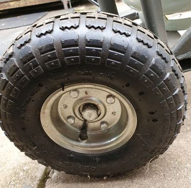

I have used those trolley wheels Mitch has recommended - they're quite good for the price.
For me - I'd be trying four wheels - and steel, for durability outdoors.

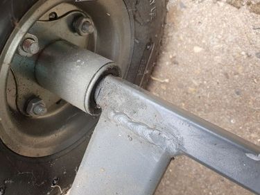

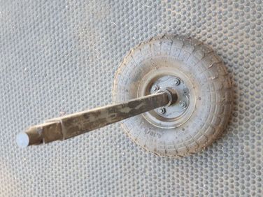

The 20mm square tube and 16mm round tube are from Bunnings. From memory the 16mm tube is designed for go-cart projects and has pre-drilled holes at the end for cotter pins (which I didn't use).
So two axles and four wheels and then attach wood to make a platform for the garden shed. Possibly an attachment for a handle at the front so that you can pull it wherever you want to.
The tube fits very snugly into the square tube (no need to weld in place) and I used a half inch imperial Whitworth bolt shortened to 25mm which I tapped a thread for.

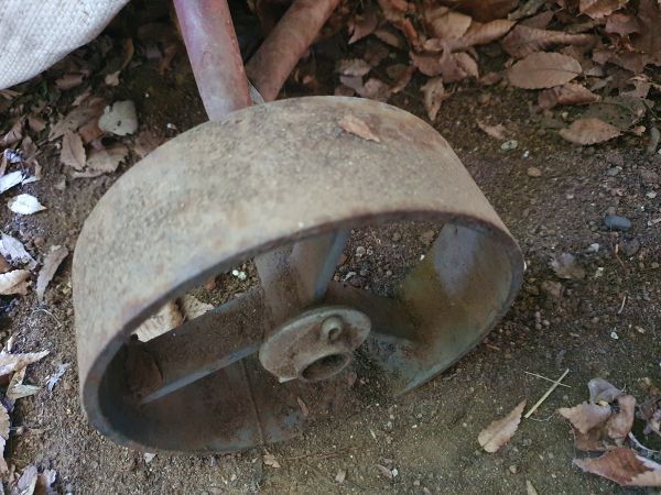

That is an excellent idea you have. When I first saw @nagumuthu 's mobile shed idea, I originally thought - all steel wheels. But is this too much engineering and metal sourcing trouble?
Can be done.

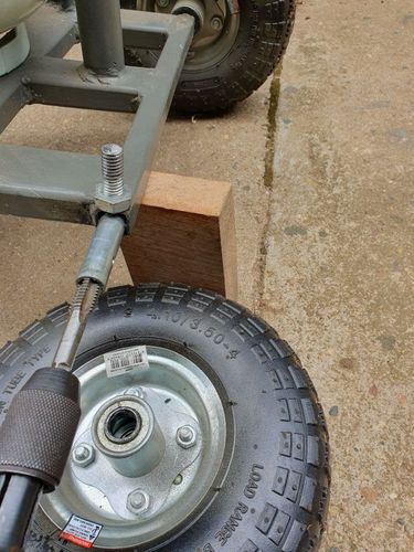

Another thought is to utilise @TheHandySqirrel 's idea of chocking up the shed - until the wheels are required.

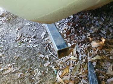

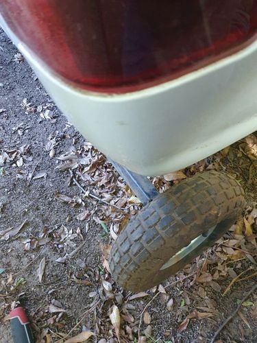

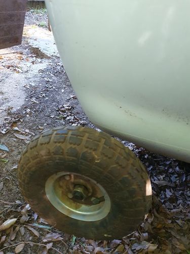

I did something similar with a silly Holden Rodeo back end trailer I have. The wheels are too far forward - so if you for example loaded it with a cubic metre of concrete mix aggregate and loaded it too far at the back - when you unhitch, you smash your jaw when it kicks you in the face.
To combat this I welded up a frame that fitted under the trailer - exposing a solid square tube rail. Prior to unhitching I remove two plastic covers to slide the same wheels as above on - remembering each wheel is rated at 300lbs.
The partial axles for the wheels are more robust and the thread is cut on 16mm rod.
It has saved my face more than once.
Make four similar mini-axle wheels for the frame - move the tool shed into position, chock it up and remove the wheels for storage until needed again.

Hi @Noyade,
That might fit a convict-era themed garden. Depends on how often you might have to move the shed, and on the strength of the human pulling it. No issues with deflation, that's for sure. ![]()
