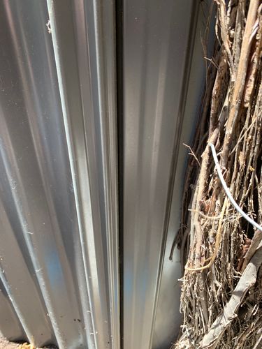

I have tried to drill into post for colorbond side but nothing I try works

The thickness of the metal would be 2 to 3 mm?
