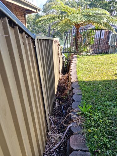

Hi gurus

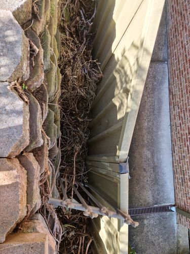

There was a vine growing over this fence that we were having to hedge and it was very invasive in the neighbour's yard down their retaining wall also. It has taken a long time to kill off but it seems we can finally proceed with somehow filling this gap.
It is not solid ground. In places you can see 3m down to the neighbour's concrete driveway. At the other end is our pool fencing and we cannot have anything that could be used to climb into the pool area. The gap is almost 2m deep at that end.
Are there any ideas for perhaps mounting brackets to the retaining wall to support pots? Or a concrete shelf over the top. We definitely want the fencing hidden.

Thanks for the recommendations particularly the privacy screen post. I don't think the retaining wall is concreted in and we're not attached to it. The colorbond fence is ours and not up to height of our built up yard due to some rules about maximum fence height from the neighbour's side. As to how its secured, we might have to venture down the neighbour's driveway to check because I can tell from our side.
Wondering whether we might be able to take down the retaining wall and somehow concrete some posts in where our grass ends, add a new screening.
There's hardly any grass and the intention is to replace it with plants with a stepping stone path to the pool gate and pebbles.

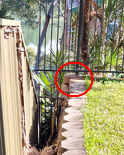

Thanks for the reply. You may not be able to tell from the photos but the garden drops away 2m at the deepest point, and you could easily sail over down an almost 4m drop to the neighbour's concrete drive at that point.
There was previously just a flimsy bit of wire and vines covering it and a bird bath in the corner where the gap is, so anyone would run into the bird bath before sailing into air.
When we purchased the property, council advised the bird bath could not stay nor be replaced by anything else that could be used to climb into the pool area.
Happy for ideas on screening the fence which would close off access to the gap also.

I keep looking at them and I must admit - I don't fully understand/appreciate the geography of what's happening - but your photo, looking down into the abyss certainly looks positively lethal with no fence at the point where you're standing. Even mowing the lawn - you must treat this area with great trepidation? I keep thinking of the movie 127 Hrs.
In the background - how is that pool(?) fence post attached?

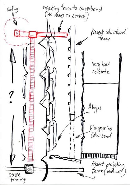

My only thought, just for safety sake - would be to delete the 'mid-air' portion of the pool fence and build (a fence of sorts) back from it to a safe distance and anchor a post into a large concrete footing. From there, project to the fence - no need to attach. The footing would incorporate a 'Z' section of steel.
And then smarter people out there can think and solve your problem - but at least that area would be safer.
