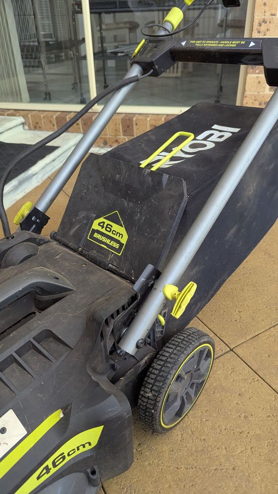

Is the handle attachment for the 36V Ryobi Electric Brushless 46cm Lawn Mower a known issue? The Torx fasteners become very loose after only 1-2 home garden mows. They require frequent tightening on both sides of the mower, as do the mounting plates to the frame.

Any chance of taking out the bolts and looking at the threads - are they stripped?
It all looks plastic to me - but what do they screw into? Can't be raw plastic surely - embedded nuts or nut rivets?
To my eyes that angular plate is basically there to assist in the handle angle choice?
Would it be worth trying locking washers with the bolts?

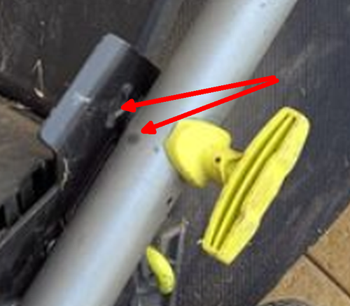

I have the same problem. Today I tightened the screws but one of them stripped out. They are only mounyed into plastic

If you would like to see about options for fixing the issue, could I trouble you to upload some photos so we can see what you're working with. Some of @Noyade's above solutions might work.
