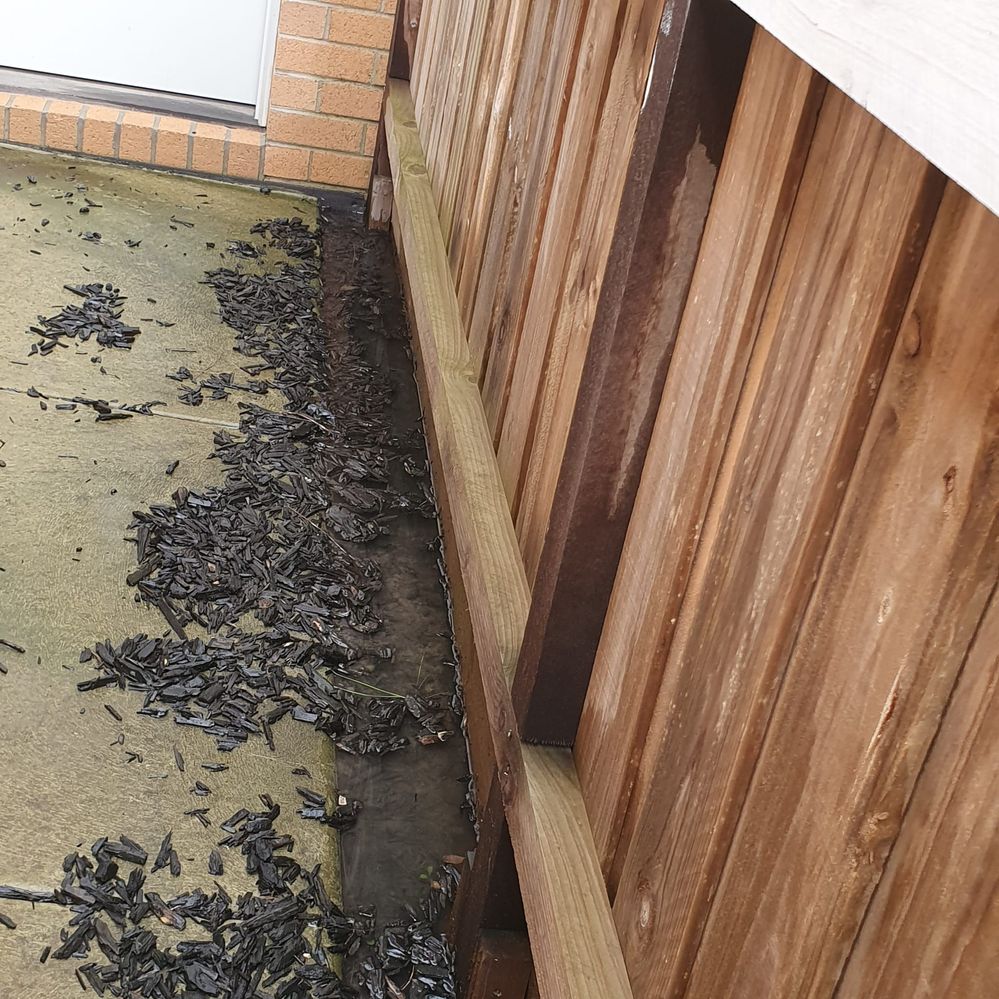

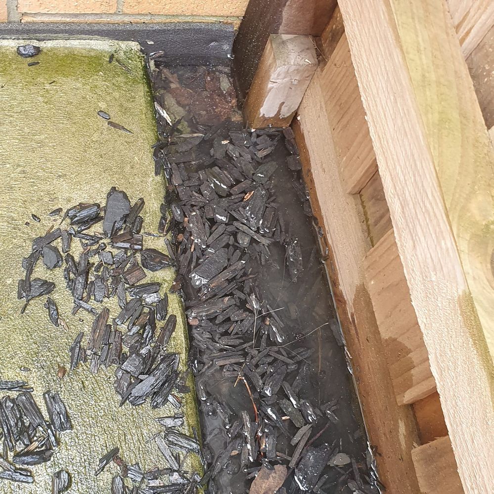

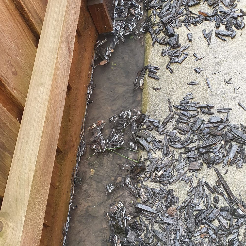

Hey All,
As shown in pics, water puddles are forming between the concrete and fence due to rains. What can I do to improve the drainage or stopping this happening?

Hi @ppp,
Do you suspect the water is being captured by the concrete slab and flowing off it into the space? Or is this water coming from the other side of the fence?
If it's from your slab, then you'll need to install some Agi Pipe under the soil there or a grate and channel on top of it and flush with the slab. If the water is coming from the other side of the fence, you'd be better off with the Agi Pipe dug down into the soil at least 200mm. Both of these options need to be connected to a stormwater pipe.

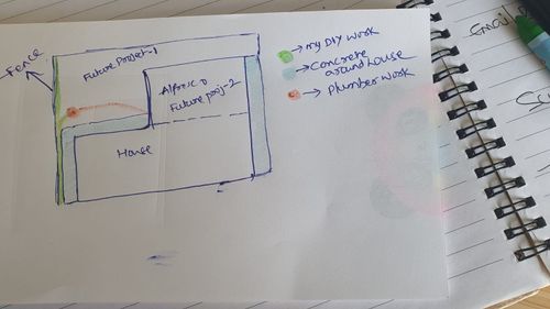

Hi @Dave-1 @MitchellMc @EricL Thank you for your suggestions. I've taken some time to decide about the next steps.
I've 2 future projects ( Synthetic grass in the back yard, Decking on the Alfresco area) so I need to make sure this drainage issue is solved at once and forever.
I would like to divide the drainage work into 2 parts and save money and complexity for me.
Part-1) Involving Plumber (Orange color in the attached sketch diag): I think as long as I have a sotrm water connection in the backyard then rest of the work can be done by myself. So I would like to involve plumber to create a storm water point in the backyard and connect it with existing storm water system. ( I guess they dig and identify the existing storm water pipes and connect to them).
Part -2) My DIY work (Green color in the attached sketch diag) : Installing AGI pipes along the fence length and connecting them to Storm water point created in Part-1. I guess this work is digging the top soil and installing them so should be fine for my skill level. And when I go for my next project which is Installing Synthetic Grass - I will make sure the entire backyard sloped into that Storm water point created at Part-1.
Part-3) Future project1 ( DIY of Synthetic grass).
Part-4) Future project2 (DIY of Decking on alfresco area).
I don't have water puddles issue on the right side fence of the house so I'm not planning for it. Do you think the above work is enough for drianage issue ? I wanted to take your opinoins on my plan and please throw if you have further suggestions, much appreciate your time.
Good afternoon @ppp
For connecting to the stormwater you actually dont need a plumber (Tho would if you are unsure of it) Id be looking to fiond the stormwater at the base of one of your downpipes and connecting to that.
You still have that Sewage access lid that you cant cover. Synthetic grass could be lifted if needed so maybe you could? Not sure where that concrete lid is on your plans.
Id put in two drainage pit style boxes in your yard, one where you have marked it and one over toward sthe side fence closer to that awning. Just to be safe. The trench you dig for the agriculture pipe to attach to the pits and the stormwater pipe should have gravel to the level of the top of the pipe before you backfill with soil.
