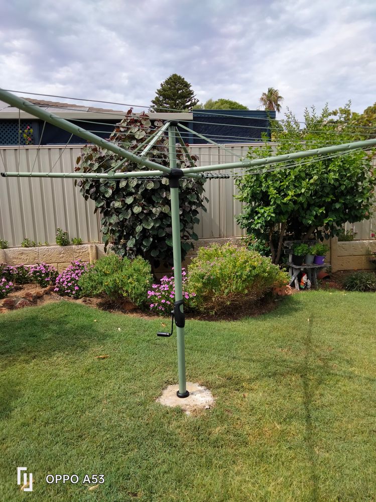

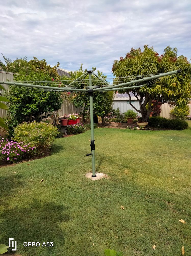

Last week we bought a Hills 45m Pale Eucalypt Medium Rotary Clothesline at Bunnings Joondalup, it has been installed to specifications. My wife, still find it a bit to high to hang the clothes and ensuring it is fully wound down. Any advice how to readjust the hight without damaging the clothesline please.

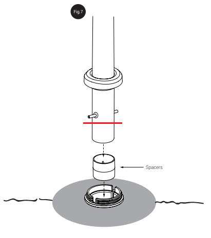

Did you happen to insert any of the elevating spacers in the ground socket? If so, they must be removed, as they'll restrict how low you can set the line.

In the meantime, if you were able to measure from the lines to the ground and possibly provide an image of the clothesline (including the base), that would assist in my troubleshooting. Let me know if you need assistance uploading an image.

Can I confirm that the latch assembly sits 1800mm above the ground? If so, this would indicate that the clothesline is set at the lowest level. From there, the outer lines should be no more than 100mm higher than that point. I understand the outer 1900mm line height could still be a bit high for some users. My smaller-statured wife would likely need to stretch a bit for that height. However, if the product is unusable for your wife, I'll gladly contact the store of purchase to discuss options.

From the ground to the top half of the latch assembly 1750m, the outer line is at 1830m, with fully wound down.

In order to lower the lines, as mentioned by @Brad, you could remove a short piece of the pole from the bottom of the clothesline. Obviously, this is not a great solution as the winder mechanism also gets closer to the ground. However, it could give you 5-10cm and make the line usable for your wife. If you do attempt to remove a section of the pole with a hacksaw, please remember your PPE, including safety glasses and gloves.

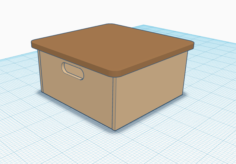

Another alternative would be using a step stool. It would be my preference to build a low and wide step that has no chance of toppling over. I've created a rendering below to illustrate.

You may need to drill a new hole and relocate the pin higher, equal to the amount you cut off the bottom.  Drill the new hole the same or slightly smaller as the pin and then use a hammer to knock in.  Everything will still work if the pin is loose in the hole, you just run the risk of loosing it if you remove the clothesline.  I would strongly recommend painting the newly drilled hole to try and prevent rusting.
