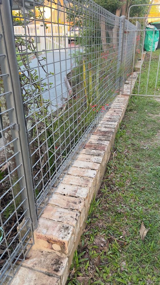

Hey team! I'm wanting to install a new timber fence down one side of the boundary at our house. We currently have a horrid wire fence about waist height. I have spoken to a few fencing specialists and they have suggested leaving the existing steel posts in and sleeve timber posts over the top, as they are already concreted in and solid. Anyone tried this before? I assume you have to pour some grout in the sleeves to secure them onto the existing steel posts? Looking for help/suggestions/recommendations.

The first photo looks like the front yard with 'your fence'.

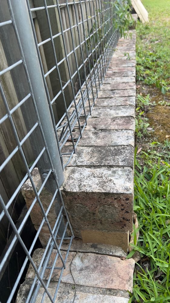

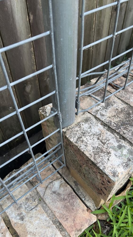

The other two photos show 'your fence' running alongside a shared timber fence.
(Not sure about the above?)
Do you only want to do the the front with palings?
If that's the case remove the brickwork and install the usual 3 rails secured with U-bolts
Install the plinth board and then do the paling thing.
Maybe you intend to remove the back wire fence?
Cheers

Yeah so we have our wire fence, then there is a gap between our's and our neighbours fence (about 300mm) so essentially there's no shared fence at all, it's a void inbetween. Which is actually pretty good.
The plan is to keep the brick wall and remove the steel fence completely, and replace it with a higher timber fence - 1.5-1.6m high on top of the brickwork. I was thinking of just ripping the whole wire fence out but have been told I can keep the steel posts only, and sleeve over them.
Yes - looking at just simple paling front.
