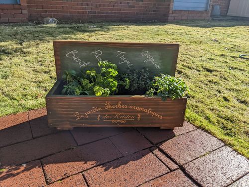

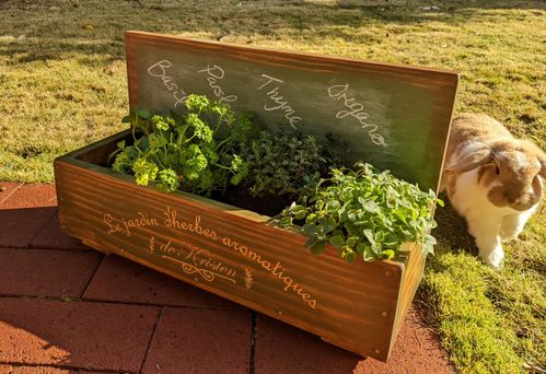

Mmm smell that basil!!! Definitely "aromatiques"Mmm smell that basil!!! Definitely "aromatiques"
14. PLANTING the "herbes"
Mum chose her own "herbes" Herbs + Potting Mix + PlanterHerbs + Potting Mix + PlanterMum's choices: Curly Parsley, thyme, oregano and basiI.Mum's choices: Curly Parsley, thyme, oregano and basiI.
             – it is KRISTEN’s "jardin" after all!!!
Uhoh...Uhoh...Uhoh...Uhoh...UHOH!!!!UHOH!!!!
After fending off the buns, I arrange and plant my herbs...
Once they're all soiled and 'pot' in together 😂 - give them a good drink of water... 👇To see me in action watch the video👇
NB: Condition the chalkboard and write their names AFTER you've watered them - otherwise you're writing will come off 🙊
All's left to do now is give it to Mum!!! Or do I wait for Christmas?
Just kidding!!!! But I did make her wait till I posted this …
                               💞LOVE YOU MUM💞
TADAAAAA!!!!!!TADAAAAA!!!!!!I hope Mum likes it!I hope Mum likes it!I know some BUNNY does!I know some BUNNY does!
